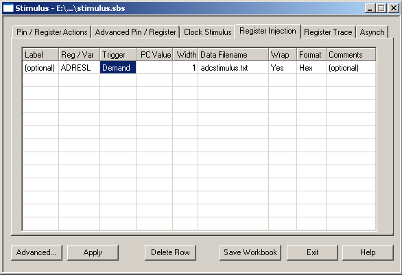

I've got stimulus on an0, ra0, adresh, adresl, but I must not be doing something right, its still not working. I've been reading the help and it helps a little but I'm still fuzzy on my particular problem. I'll try changing the values some more and see if that helps tonight, even though I'm not getting any results any way. I may take a sixxer to fix it.
just setting up stimulus in the "pin/register actions" section, or are you doing an actual stimulus file via "register injection"?
since you mention ADRESH and ADRESL separately I'm guessing you're using regular stimulus rather than register injection.
In the register injection method, you feed in 12-bit values (as 16-bit hex numbers) from a stimulus file, to the ADRESL register. It's smart enough to break the value in two and put it in both ADRESH and ADRESL appropriately.
A picture is worth a thousand words, so one is attached. This is from MPLAB 7.50, things may be different in old versions as I remember they changed the stimulus stuff quite a bit a few releases ago.
The contents of 'adcstimulus.txt' is just hex values, one per line:
0x0101
0x0123
0x0321
(etc...)
Every time the program performs a read on the ADC, it will just grab the next value from this file.

Sweet, man! Thanks for the screenshot it was just what I needed! I built a text file with all the analog values and slid it into the "data filename" slot and it worked great! I've had this project on the shelf for a while, but this is just what I needed to get it going again! Many thanks!

That is correct, you have the ADC set to left justify and so the 0x123 get shifted left 6 times to become 0x48c0.
