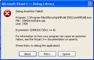

hi, the last time i used the mplab sim, it was ok, my programs were running smoothly in it, but lately i'm encountering errors. The programs do not have any errors in building, the only error is in the mplab sim part.here's the error that pops out:**broken link removed**
and after closing that window, i get an error about the mplab and the mplab suddenly exits. What could have gone wrong?could it be a virus or something?

Seems like a type cast failure, nothing much you can do about it.
Have you tried starting a new small test project and simulating that?
maybe there's someting wrong with your project wich crashes the sim.
If it crashes on a new small test project too then try a reinstall - perhaps a newer or older version.

hi guys, thanks for all the replies and sorry for all the trouble that i've caused :oops: i found the problem! i made a project for a pic16f84a, but the program i wrote is for a pic16f84(PROCESSOR P16F84). thanks and sorry again for all the trouble :D
