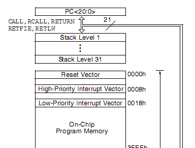

hi Inq,
Check the PIC's memory map for location 0x12.?
Eric

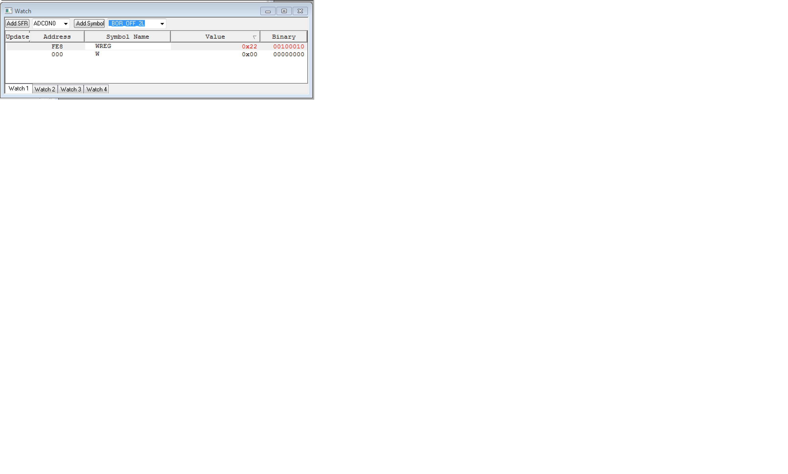

Do I specify 12H as a viewable location or have to set it up somehow. It is not an option in "Watch" window
Notice how the address for W shows as 000 and WREG as FE8.
Like Eric said, you still have to consider where program memory starts. What harm is there is doing what he suggested?

With all due respect I did try 0x30 and it also showed zero address. I had a copy of the screen snapshot handy and it also showed zero at 0x20 so I used that screenshot as my example. It did not seem to make a difference. MPLAB version is 8.92.

Thanks Eric. That works.
From what is seen here the file register F is viewable but W is not.
Thanks to all who helped. Much appreciated.
That is correct, w itself is not viewable. But all of the chips I have seen had an SFR called WREG or something similar, which mirrors w.
John
At least all the 18Fs do.
