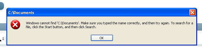

Now I checking to run it.Does the files need to be in the same folder = detab+asm file?
One check it says you have typed incorrectly
C:\Documents and Settings\Gayan\Desktop\New\detab.exe 12 Light Controller.ASM Light Controller.txt

No but you'll have to enter the file path so it's easier if they are.
C:\Documents and Settings\Gayan\Desktop\New\detab.exe 12 Light.asm Light.txt
You need to open a DOS command window - Start - Run - CMD
Then CD into the directory and run from there, I usually just dump a copy of the asm file into the root of C then run it from there since it saves typing a long path, but works from anywhere.
