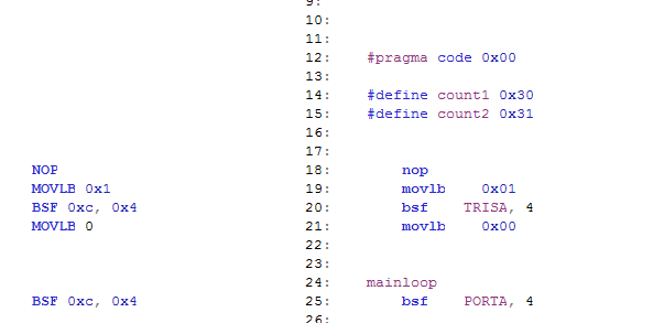

I've just started using a PIC12F1571, which is only supported with MPLAB X. I'm programming in assembly, and the only file that is included is the p12F1571 file that Microchip provide.
For some reason, MPLAB X adds two RETLW 0x00 lines at the start, which prevents the program from running due to stack underflow.
How do I stop that happening?
Your using the generated asm file or a blank. Mine didn't add nothing i tried a blink. I'm using 4.05 of mplab
I'm using MPLAB X IDE v3.55
I started with a blank asm file. Here is what is contains:-

Here is what the output of the assembler is:-
      Line      Address       Opcode      Label            DisAssy
       1     000           3400                    RETLW 0x0
       2     001           3400                    RETLW 0x0
       3     002           0000                    NOP
       4     003           0021                    MOVLB 0x1
       5     004           160C                    BSF TRISA, 0x4
       6     005           0020                    MOVLB 0x0
       7     006           160C                    BSF PORTA, 0x4
       8     007           0BB0                    DECFSZ 0x30, F
       9     008           2807                    GOTO 0x7
      10     009           0BB1                    DECFSZ 0x31, F
      11     00A           2807                    GOTO 0x7
      12     00B           120C                    BCF PORTA, 0x4
      13     00C           0BB0                    DECFSZ 0x30, F
      14     00D           280C                    GOTO 0xC
      15     00E           0BB1                    DECFSZ 0x31, F
      16     00F           280C                    GOTO 0xC
      17     010           2806                    GOTO 0x6
I have not seen the statement "#pragma code" in assembler. (I think I have seen it in a "C" program but I dont understand "C") What does this do ? Also you have no org statment to tell the assembler which address to start the code at. I have just had a look at MPASN v5.55 (Which I use at the moment.) and the PIC12F1571 is supported in that.

This is what I got
Disassembly Listing for test
Generated From:
/home/burt/code/asm/dist/default/production/asm.production.cof
Nov 28, 2017 5:15:49 AM
---  /home/burt/code/asm/newpic_8b_general.asm  ---------------------------------------------------------

0002  0000     NOP                                19:        nop
0003  0021     MOVLB 0x1                          20:        movlb    0x01
0004  160C     BSF TRISA, 0x4                     21:        bsf    TRISA, 4
0005  0020     MOVLB 0x0                          22:        movlb    0x00
                                                  23:
                                                  24:
                                                  25:    mainloop
0006  160C     BSF PORTA, 0x4                     26:        bsf    PORTA, 4
                                                  27:
                                                  28:    loop1
0007  0BB0     DECFSZ 0x30, F                     29:        decfsz    count1, f
0008  2807     GOTO 0x7                           30:        goto    loop1
0009  0BB1     DECFSZ 0x31, F                     31:        decfsz    count2, f
000A  2807     GOTO 0x7                           32:        goto    loop1
                                                  33:
000B  120C     BCF PORTA, 0x4                     34:        bcf    PORTA, 4
                                                  35:
                                                  36:    loop2
000C  0BB0     DECFSZ 0x30, F                     37:        decfsz    count1, f
000D  280C     GOTO 0xC                           38:        goto    loop2
000E  0BB1     DECFSZ 0x31, F                     39:        decfsz    count2, f
000F  280C     GOTO 0xC                           40:        goto    loop2
                                                  41:
0010  2806     GOTO 0x6                           42:        goto    mainloop
                                                  43:
                                                  44:
8007  0000     NOP                                45:        end

What happens if you use a more conventional beginning based on the old templates, e.g.,
    ORG     0x0000            ;processor reset vector
I think that was what I needed. It now puts the code at the start and runs it. Thanks for your help.
You do know that you can start with the simple asm file and set you configure and it add's org for you.
You get a file like this to start......
