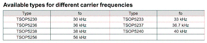

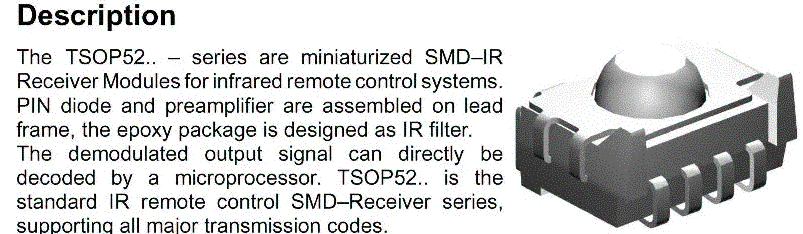

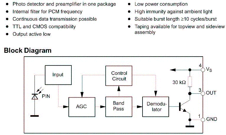

I want to be able to control all my hifi-gear in the living-room
from my hobby-room and bedroom.For this i need some kind of IR-
receivers/amplifiers that converts signals from all sorts of remotes to
square-waves and puts it on some kind of cable like coax or twisted
pair.in my living-room I need a simple transistor based IR-driver
to transmit this signal back to the hifi-gear.
The difficult part is designing the ir-receiver, maybe someone have links
to similar projects.I know there excists a variety of IR amplifier ic`s,
but those are usually tied to fixed frequencies, and may not be fully
compatible with my setup.
Thanks in advance for your answers.

A possible solution.
