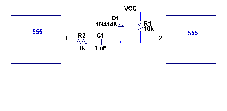

Arnold, try this interstage network between your 555s. The trigger time constant is 11usec, and the recovery time constant is 1usec. It should recover in plenty of time. The diode allows the cap to recharge quickly on the positive edge, and the 1k resistor limits the current through the diode.

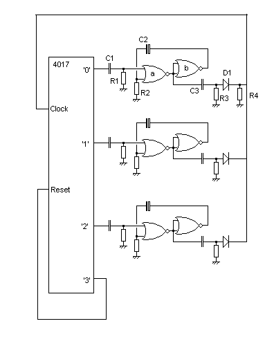

How about abandoning the 555s (the old-style ones take massive current spikes when they switch - 1/2 amp or so ...)
If you use a 4017 as the sequencer and trigger a monostable from each output you can alter each mono time. All the monostabs are diode-ANDed together to give the clock pulses for the 4017.
If you want less than the full 10 outputs simply diode the first spare output back into the reset input.
I have shown monostables formed from two 4001 'NOR' gates but the idea is the same if you stick with 555 timers.
The timing for each monostab is calculated as 0.5*R2*C2 (As I have labelled components) so a 1Meg variable resistor and a 33uF cap will give upto about 15 seconds.
R1 and C1 act as pulse shapers to give a short trigger to the monostab (maybe 22k and 0.1uF for a 1ms pulse?)
R3 and C3 act as pulse shapers for the monostab output (22k and 0.1uF again?)
D1 (one diode from each monostab) forms the AND gate and R4 (10k to 1Meg - doesn't matter!) just stops the AND gate's output floating when there is no pulse.
If you want just a single stream of pulses form a single output then you could use the clock line but the components suggested will make each pulse only 1mS long ... If the pulses are full-length from each mono then the output would be a constant DC anyway, maybe you want to control pulse ON and OFF times independently? (this will double the number of knobs to fiddle with though).
