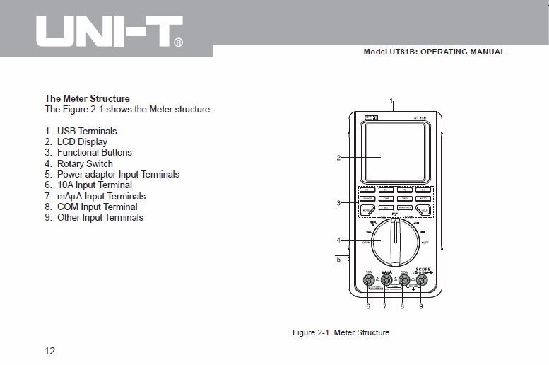

here is a multifunction DMM with built in oscilloscope. It is manufactured by Uni-Trend, Hong Kong. Type name is UT81B.
I guess it is very useful concerning signal tracking. The built-in scope is not the best concerning focus, but the monitor-display via software (USB) is OK.
The USB adapter slips over the enclosure for IR-transmission (no pins to bend and no corrosion as well)
It features autoranging from µV/µA to 750V AC/DC and 10A max current measurement.
The oscilloscope has a max input frequency of 10MHz and should suffice even for applications using an MCU.
I don't know the overseas price. In Thailand I spent 9,500 Thai Baht (US$270).
If you are interested check out: https://www.uni-trend.com
No pricing on the website and no direct sales.

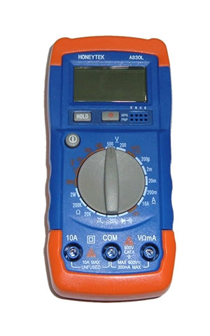

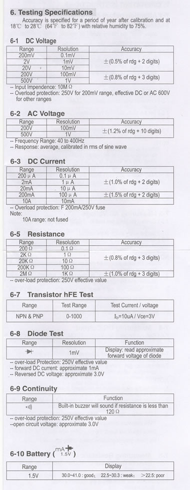

I purchased this meter last week just only for 8$.It meets my requirements & the readings were perfect.So why spending too much on the ranges that you will never go ?

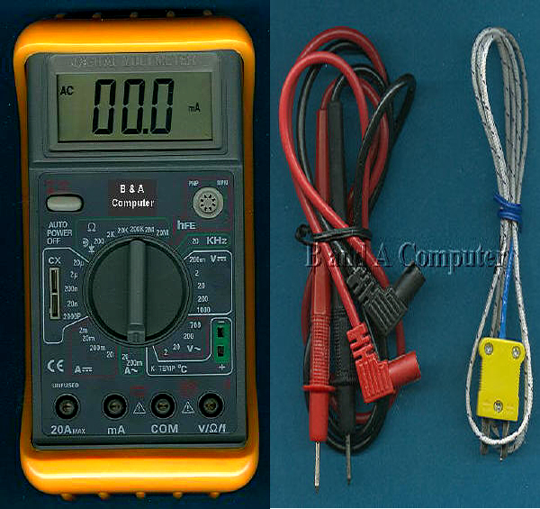

Here is one I found on eBay... Might be more pricey than a cheaper unit, but what do you think of this?
* Professional quality portable handheld digital multimeter!
* Accurate, reliable, and ready for use!
* Easy to read 3 1/2 digit LCD display!
* Feels good in your hand!
* 30 ranges:
o Resistance: 200, 2 k, 20 k, 200 k, 2 M, 20 M Ohms
o Capacitance: 2000 pF, 20 nF, 200 nF, 2 uF, 20 uF
o DC Volts: 200 mV, 2 V, 20 V, 200 V, 1000 V
o DC Amps: 2 mA, 20 mA, 200 mA, 20 A
o AC Volts: 2 V, 20 V, 200 V, 700 V
o AC Amps: 200 mA, 20 A
o Frequency: 20 kHz
o Transistor hFE
o Continuity/Diode test (with beep)
o Temperature (Internal sensor): 0 to 40 C
o Temperature (Thermocouple): -50 to 1000 C
* Includes regular and thermocouple test leads!
* With instructions!
* Colorful retail box!
* Battery IS included!
* Very high accuracy!
* Fused for protection!
* Thermocouple socket!
* Low battery indicator!
* Meets CE requirements!
* Includes a fold-out stand!
* Self zeroing on all ranges!
* Pushbutton power switch!
* Auto power-off saves battery!
* With removable yellow holster!
* Transistor socket for hFE measurement!
* Bright yellow soft holster protects meter!
* Four standard banana jacks for test leads!
* Uses a standard 9 Volt rectangular battery!
* Capacitor socket for capacitance measurements!
It cost $23 plus $7 shipping... This link may not work after a while but here it is as of now...
Here is the sellers eBay Store:
Is this overpriced?
Dennis
hi Dennis,
Looked at their website, its not a brand name I recognise, but the spec looks OK.
Price is a little high, how much looking around have you done.?
The only draw back I can see is that it dosn't have a sheep shearing attachment..:rolleyes:
