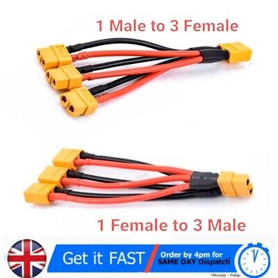

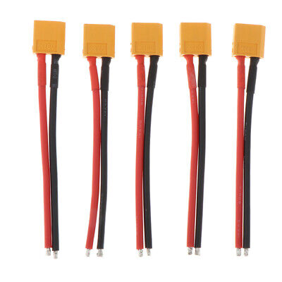

For 12V use from a fused cigarette lighter plug, such as XT30 or XT60 connectors. They are small, cheap and reliable.
Just remember that the cigarette lighter will be fused at probably 10A (or just possibly 15A/20A) in the vehicle so the total load cannot exceed that.
Get the ones with insulation boots, or at least heatshrink to protect the connections:
You can also get ready made splitter harnesses:
Or connectors with flyleads fitted, etc.
XT30 look similar but are a bit smaller (or XT90 are rather bigger).
