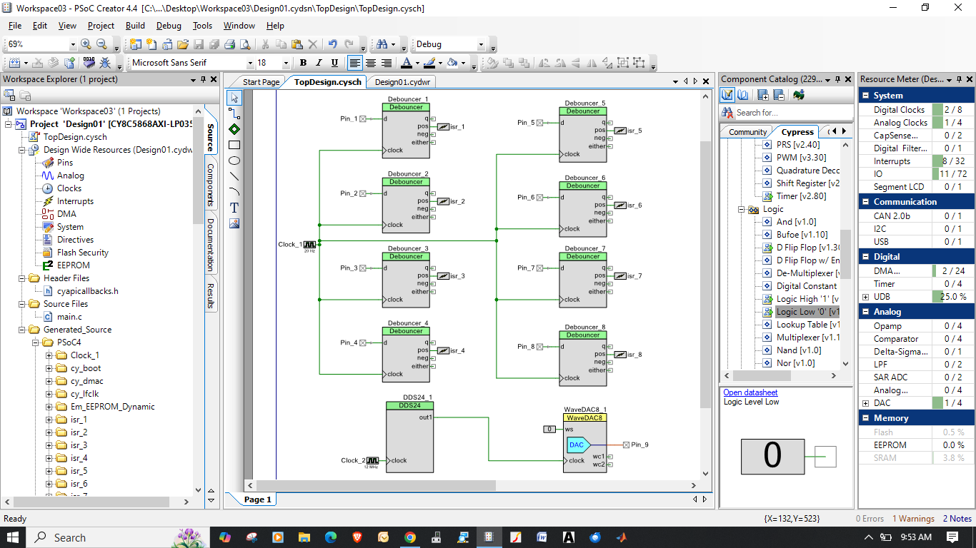

Here is a single chip solution, 8 keys (I think based on resources left might be
able to do 32 or more). Each key debounced. I chose ISR to handle each key.
You could use onchip reg to read the key vs the ISR approach. Or a scanned mux,
many possibilities, again all onchip. The result of the key controls the DDS in turn
feeds the Wavedac to produce sine/tri/ramp/square/arbitrary to gen sound if so
desired.

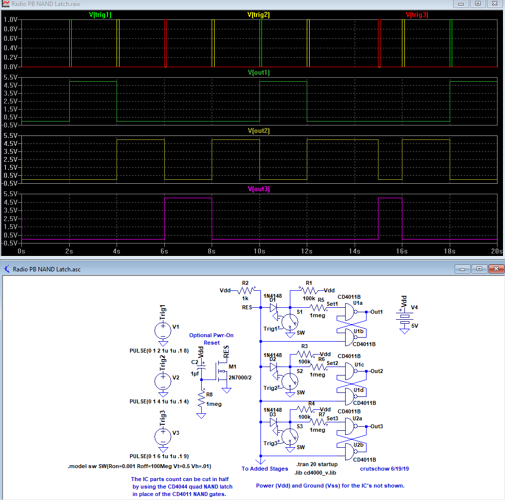

For your amusement to puzzle out how it works, below is the LTspice sim of a NAND-latch based Radio PB circuit (hint -- the 1MΩ resistor is necessary):
The SWs are NO PB switches.
The circuit is immune to switch-bounce.
Note that the output latches to its respective input, no matter the input sequence.

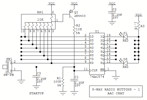

Here is one I posted on another forum. It uses a different approach that Carl's. Connecting C3 to any of the switch inputs makes that input default ON at power-on.
ak

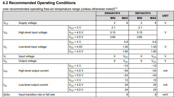

I assume the purpose of C1 is to delay the clock until the D input has settled, but that seriously violates the MAX transition time for the clock (below), and could result in spurious operation of the FF.
The normal BJT turn-on delay should be all you need.
Also the slower 74HC374 / 74HC574 (differ only in pinout) has a more relaxed requirement for the clock transition time (≈100ns/V @5V), so might be a preferred device to use here, since operating speed certainly isn't a consideration.

Well, you threw a much of spaghetti on the wall but none of it really sticks: :rolleyes:
Connecting large C's to CMOS pins not a good idea -
There is no capacitor on the output.
The input capacitor is only charged during the PB on time, and discharges through R1, not the substrate diode.

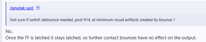

Not sure if switch debounce needed, post #14, at minimum visual artifacts created by bounce ?
No.
Once the FF is latched it stays latched, so further contact bounces have no effect on the output.

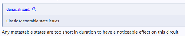

Classic Metastable state issues
Any metastable states are too short in duration to have a noticeable effect on this circuit.
