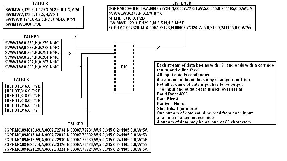

ok here goes i have a device that takes input (sentances) from several different peripherals using serial but only has one socket. the device is a marine gps/plotter/fish finder/weather indicator depending on what type of peripheral is conected to it. the data provided is in a format called IMEA 0183 an explanation of which is here :- https://www.windmill.co.uk/monitor52.html
My question is could a microcontroller take in serial data from several peripherals at once and send the collected data all together down one serial line to the device, the device is capable of understanding data from several devices at the same time but with only one serial line in, i would have to use a multiplexor which is available but the price is very prohibitive.

By the way as the data stream is contant from each device (talker) it dosnt matter if while collecting data from one device (talker) the others are ignored as long as the data being collected and sent on to the listener has no gap greater than 5 seconds max

If each individual device is sending out the message repeatedly, then it is simple to just listen to one channel, wait until a $ is received and forwards the message to the listener.
Then one moves on to the next channel down the line. In actual fact, the PIC can even send the "$" to the listening device before it detects a valid "$" from one of the 8 individual devices.
If this is what you wants, then it is easily implemented because you are using one software USART instead of many. It is just the input pin has changed.

OK. Sending to the listening device is easy once you have setup the correct baudrate on the PIC hardware USART. You just dump any 8-bit value into the Tx buffer and it will be sent. Initially send a "$".
Get hold of a software USART code routine from the internet and either:
1. modify the code to have it operates on a different input pin as per a variable value OR
2. repeat the code eight times using different port pin as input.
3. after the character is "capatured" via the routine, check for "$". Loop until found.
4. capture another character, check that it is not a "$" and then dump it into the hardware transmit buffer. Loop until "$" found.
5. wait a short while and send a "$". Moves on to next channel.
Is that OK?

i have jotted some pseudo code (of a sort) down to see if the structure is right before i start on the proper code. any input would be great.

below is an image that may make things more clear.
