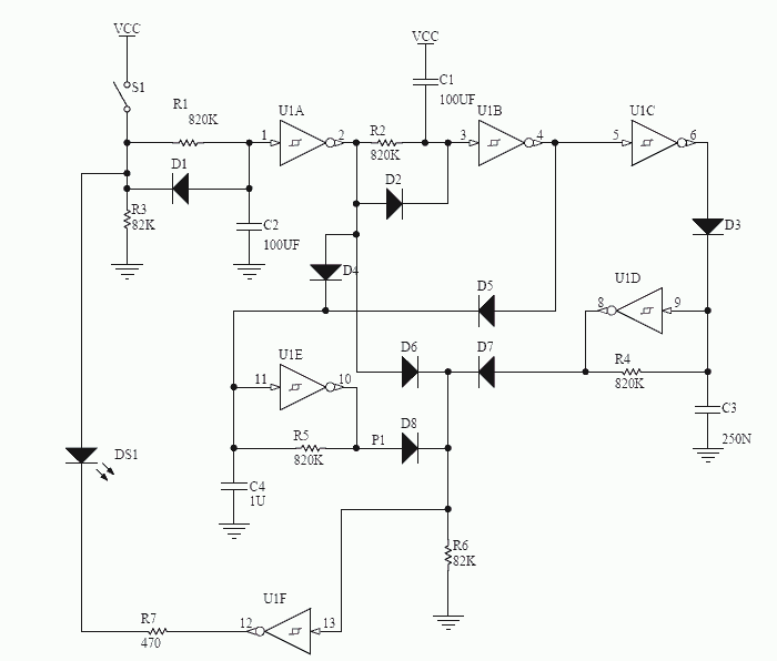

I am looking for advice on the best/most efficient way to set up a sequence of led flashing events without the use of a microprocessor. The start of the sequence will be initiated by an optical sensor detecting a switch on position. The sensor output will remain high in the on position and low in the off position.
Once triggered the single led will turn on steady for 1 minute and then begin flashing at 1 flash per second for 1 minute (on 1 sec/off 1 sec). At the end of that minute it will start flashing at a rate of 1 flash per 250ms (on 250ms/off 250ms) and remain in this state until the switch is moved to the off position. So the led conditions are:

I am thinking I can do this with a couple of 556 timers but am not sure how to trigger the sequences. Any advice would be greatly appreciated or perhaps 555's are not the best route to take. Again I would appreciate any advice. Thanks to all.

See attached. Component values will need tweaking depending on how pedantic you are re timing.

dougy, I'm not much of a discrete logic guy, can you put down a few paragraphs about how that circuit functions? I wouldn't think you could get such complex behavior out of such a simple circuit.
Well... this is probably going to be harder than drawing the cct...
With the switch open, the LED won't operate. Also, c2 & c1 are discharged. So, u1a out is high, u1b out is low, u1c out is high. u1f out is low due to high through d6. Both oscillators are disabled by the high levels through diodes to their inputs.
When the switch closes, the led conducts. after 1 minute, c2 charges enough to flip u1a output to low. So d4 & d6 no longer conduct. u1e is now able to oscillate @ 1Hz, which pulses the LED at this frequency.
After 1 more minute, c1 is charged enough to flip u1b output high. u1e osc is disabled through d5. u1c output goes low, u1d osc is enable as d3 no longer conducts. u1d osc pulses led @ 4Hz. From now on nothing new happens, so 4Hz pulse continues.
When switch is opened again (LED off - C2 may discharge through it), C2 discharges through d1 & r3, then c2 discharges through d2, now everythings back to the original state.
simple circuit.

It has to do with with the fact that if I use a microprocessor there will be software involved and that will require software validation for this project. I would prefer the processor approach but my requirements state no microprocessor. Thanks for the reply.

Dougy thanks for the circuit explanation and Sceadwian, thanks for asking for it. I would have had to build it first and probably still not fully understood the circuit. I'll build it this evening. I am still curious about the 555 approach. Do you guy's think using the timer is out of the question? Would it take more components or just be less practical?
The 555 would take more. It's a pretty nifty circuit using only a single IC. (Of course a small 6 pin micro would be simpler)

Thanks for the insight Blueroom. The circuit will be packaged in a small hand held device used for measuring liquid flow. The different led flash rates are to indicate the passage of time at a high flow rate condition. This is a small part of a larger medical device.
All the gates in the proposed cct can be in the same 14-pin IC. You could replace each of the schmitt trigger gates with a single 555. You could possibly redesign it to use 3 x 555 (2 for timing & 1 for dual-speed oscillator), but I don't see the point; the 555 approach will be bigger, and consume more power. The fact that it is a 'small hand-held' device would generally mean that both size & dissipation must be limited.

No microprocessor Sceadwian. The device is measuring flow in one of three states, hi, low and no flow and is done with discreet components only. It is a time of flight measurement using a comparator and thermistors. The output condition is displayed through led's. The part of the circuit I am working on is a flashing indicator letting the user know how long the device has been in a high flow condition.
This is the approach I was contemplating before posting here. I agree, I dont see the point after seeing your solution.

The client has set the requirements and for the section I am working on this translates to no microprocessor and the led's must flash as indicated. Timing is not that critical as it is a visual indicator. Thanks for your help on this I was looking for a more practical solution and this seems to be it. I'll let you know how it breadboards out.

Dougy does the schmitt trigger need to be of the cmos variety for this circuit?
Yes it needs to be cmos.
