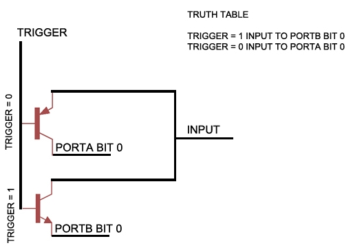

OK To better explain what i need:
trigger-jpg.42591
I need a IC with like 8 of those so its 2 8 bit ports... conrtolled by some means of a SELECT type pin

When I look at the diagram, I am thinking of 2 hc595's with two small signal transistors on the enable pins (i.e chip select). But that multiplexes one port for two 8 bit outputs, not the question, so surely have misconstrued. If that's not the answer, then why not just do it in software to change the ports? like an interrupt on change pin.
