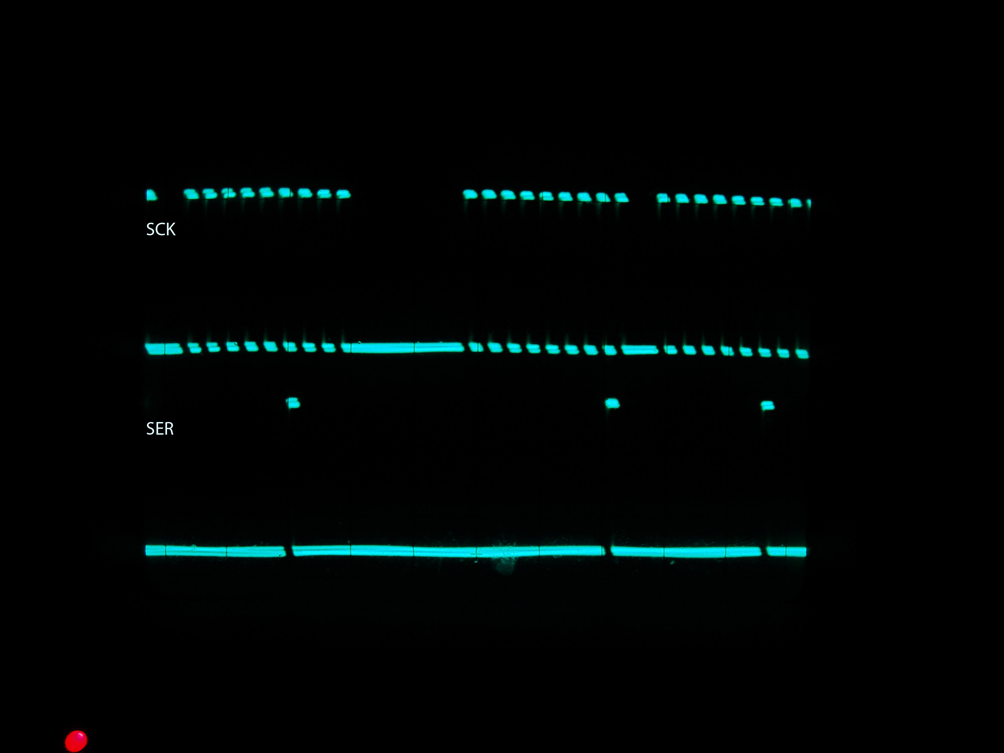

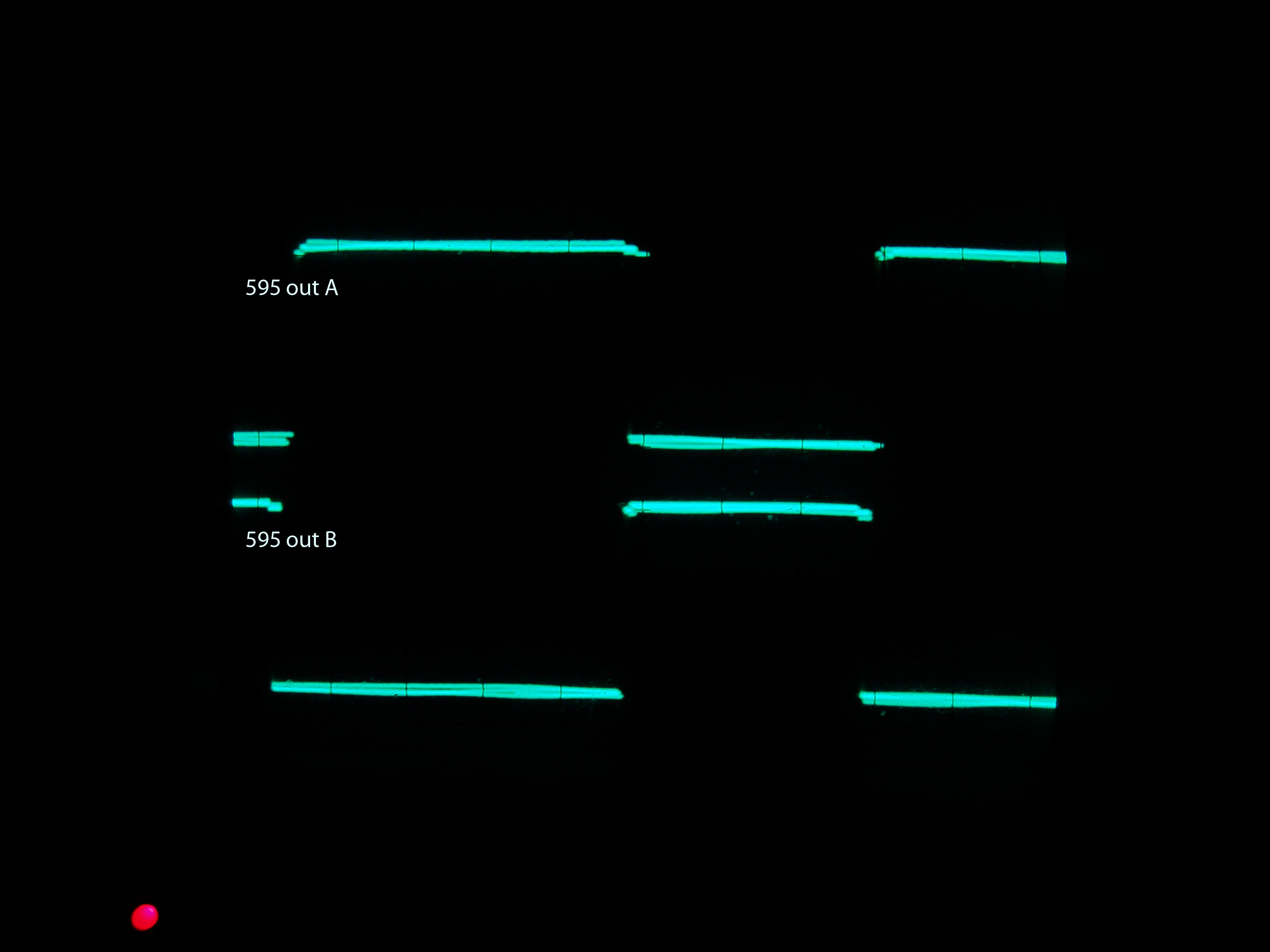

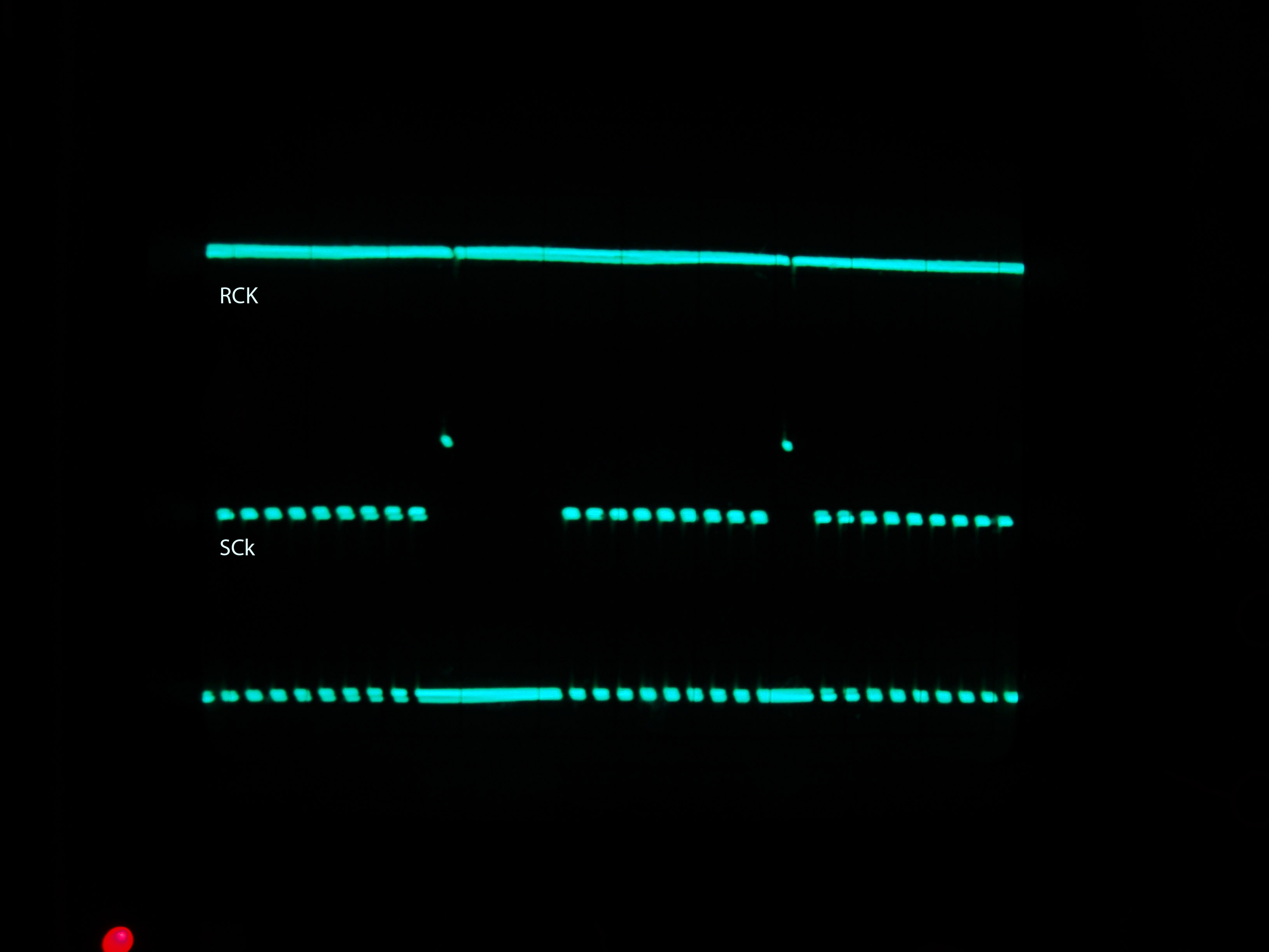

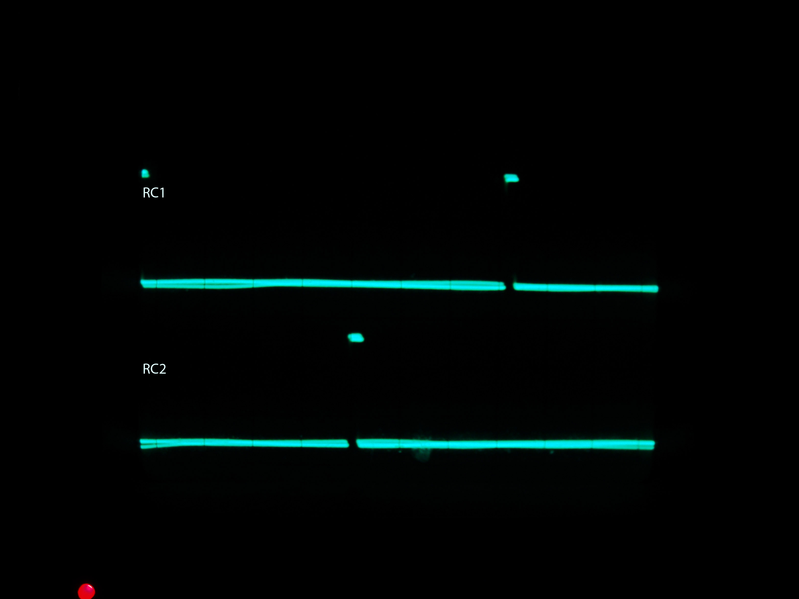

The Goal here is to illuminate only two leds. There are 16 LED's in total, 2 buses of 8. The 595 controls the output for each of the 8 led's per bus.
Now, enter the issue I'd like to fix, I made a similar example graphic. see attachment LED Bleed.jpg
For some reason unbeknown to me, Other LED's in the arrangement are illuminating when they shouldn't. If I could fix that I'd be a lot further along.
I have also included pictures on my 2 channel scope readings for the outputs.
Aaaand secondly, I have a separate MCU clock configuration question. In building this project I have been working with the MCU's internal RC clock. In trying to see if something was up with my clocks speed, I switched from a PiC182450 to a PIC16684.
According to the datasheets, the two have different internal clock speeds:
PIC16 8 Mhz
PIC18 31.25Mhz
one would think The pic 18 would be faster but apparently, according to my scope this exact program is running significantly faster on the PIC16. So I am guessing something is wrong with my PIC18 config settings. For instance these scope readings are at 1ms on the PIC18 but to get the same scope readings on the PIC 16 I have to turn the time division up to 2µs.
here are my configuration words for the pic 16:
__CONFIG(FCMDIS & PWRTEN & WDTDIS & INTIO & MCLRDIS & IESODIS & BORDIS & UNPROTECT);
and for the pic 18
__CONFIG(1, INTIO & CPUDIV1);
__CONFIG(2, BORDIS & PWRTDIS & WDTDIS);
__CONFIG(3, LPT1DIS & MCLREN);
__CONFIG(4, XINSTDIS & STVRDIS & LVPDIS & DEBUGDIS); //& ICPORTDIS
What gives??
