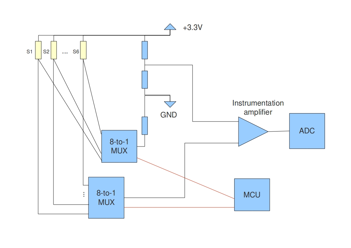

I intend to use a single A/D channel with one InAmp and one Wheatstone bridge in quarter-configuration at its input as AFE for an array of multiple strain gauges with nominal resistance of 1kΩ. Obviously, this needs to be implemented with a multiplexer (only solid-state solution is acceptable). However, I am concerned of the error that will be introduced by the on-resistance of the MUX. Do you think that this issue is important? As far as I have seen in the market, the lowest on-resistance that can be selected is 300mΩ.

Well, I admit that I do not understand what you mean. Isn't the impedance of the MUX stable? The datasheet says that the ron is at most 0.3Ω for example. It doesn't say that the value of this resistance is in portion to something else. But anyway, the strain gauges will be connected with a three-wire configuration in a quarter-bridge. Thus, two MUX are needed, as seen in the figure below. For the one that connects the measuring cable to the InAmp I agree, that the error is quite small. But the second MUX in fact changes the impedance of the left arm of the bridge.

How about you post a schematic so we all know which configuration we're talking about?
You have right, sorry for that. I had already posted the schematic by the time that you posted your own words, so you couldn't possibly see it.

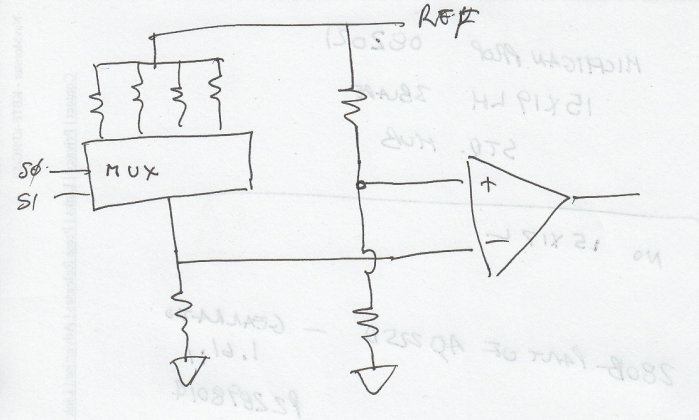

Why do you need two muxes?
Let me rephrase the requirement. Make the mux resistance small compared to the source resistance of the strain gauge. Make sure all of the channels of the mux have well matched ON resistance.
Regarding your first question, please have a look at the schematic that I have posted. Is that completely wrong? Regarding the rest of your answer, I just cannot understand why well matched ON resistance between the channels of the MUX is so important. But anyway, I will pay attention to this when choosing the device.
Here is what I was thinking:
Yes, I have understood this. But the other connection (with 3 wires for each strain gauge) is better if the sensors are to be placed in some distance from the measuring point, which is what is happening in my case.
If you want to minimize the effect of the switch resistance controlling the voltage to the strain gage, you could use a constant current source in place of the 3.3V constant voltage source. That would provide a constant current to the strain gauge bridge, independent of the switch resistance. You just select the constant current value to generate the desired voltage across the bridge resistance.

Putting a single multiplexer between the center tap of the gauge and the input node of the instrumentation amp will minimize the offsets due to the ON resistance of the mulitiplexer transistors because the current flow is just the input bias current of the instrumentation amp, which will be tiny...
