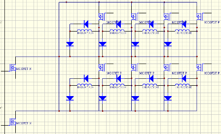

What is wrong with driving the columns of your matrix with a high side P_FET and driving the rows with a low side N_FET? You will need some level translation circuitry to high side drive your PFET (and possibly another opto coupler). It would be an EMC nightmare, but structurally it looks quite straight forward.
I also notice you have no back emf diode across your solenoid.

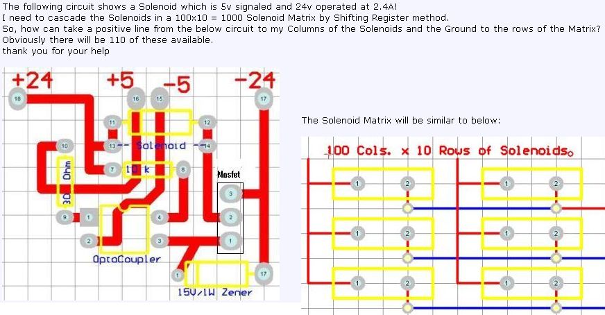

EMF Diode is connected on pads 11 & 12?
Please explain your concept a little more clearly with detail and schem. for this noob to understand, maybe an example?
thanks
Please see attached.

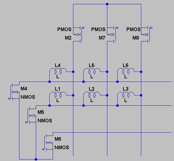

To switch on L6, drive M8 and M4. To drive L2, drive M7 and M5.
Please note, there is no connection between the horizontal lines and the vertical ones.
Does this OK, or have I misunderstood you?:confused:

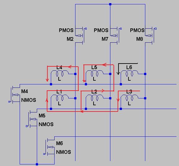

You need a back emf diode on each solenoid, but equally important you need a forward diode too.
The sneak path through L3 will energize M5, which will drive L2 and L5 in series, plus L1 and L4 in series.
..The path through L5 will energize M4, and drive L3 and L6 in series plus L3 and L4 in series.
Why do you need a forward diode too? The PFETs are only ever driving positive and the NFETs are only ever sinking current?
What is a sneak path and how will it energise a MOSFET that is turned off?
(To keep the circuit simple, I have disregarded the driving circuitry around the MOSFETs.)
Please explain
Black arrows show where you intend the current to flow.
Red arrows show where it also flows.
I see your point - so you will need a diode in series with each coil and one in parallel pointing in the opposite direction to snub the back emf.
