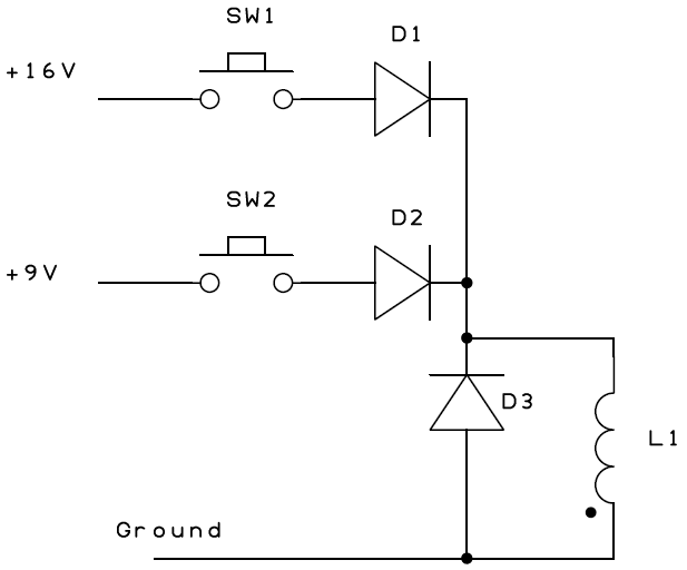

You could use this circuit.
I don't know what you are using as switches, so I've drawn them as physical switches.
You could manage without D1. D2 will stop the 16 V feeding back to the 9 V. D3 is the freewheel diode.
The problem with this circuit is that when the solenoid is turned off, the voltage coming from D3 has no place to go because D1, D2 will block it.
And without D1, D2, the two power supplies are shorted together which is not good.
This problem seems easy at first look, but it is a bit tricky to resolve.
There is no problem.
There is no voltage from D3 to go anywhere.
D3 creates a circulating current in the relay coil, this circulating current dissipated the energy from the collapsing magnetic field in the relay coil.
The voltage across D3 during this discharge period (a few milli-seconds) is about 0.6v (the forward volt drop of the diode).
The circuit proposed by Diver300 will work well, as will the proposal by rjenkinsgb.

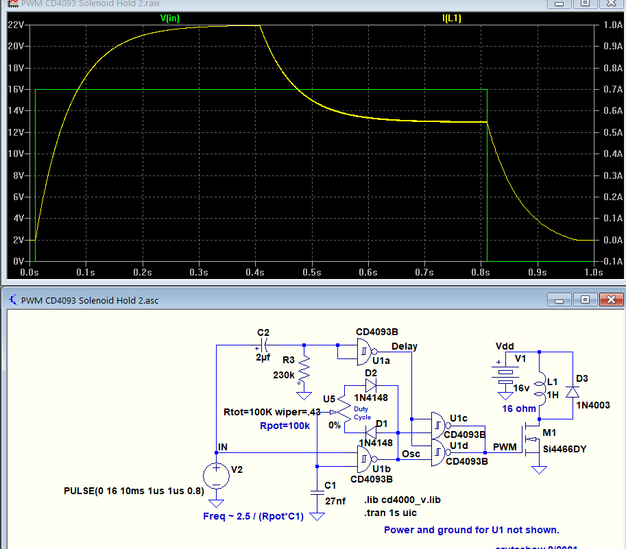

Do you actually need the two different supplies or can you just add a resistor in series with the solenoid to reduce its voltage from 16V to 9V?
If that consumes too much power, you could use a PWM circuit to start with the max 16V and then reduce that average solenoid voltage to 9V from the 16V supply, with high efficiency.
Below is the LTspice simulation of such a circuit using one quad CD4093 dual Schmitt-trigger NAND-gate package:
When the control input V2 goes to 16V (green trace), the circuit initially applies the full 16V to the solenoid so it's current (yellow trace) rises to 1A.
Then after a delay determined by the R3C2 value, the PWM is turned on, which reduces the solenoid current to about 0.56A, as determined by the PWM duty-cycle setting of pot U5.
Due to the efficiency of the PWM signal, the average current drawn from the V1 supply at that point is only about 320mA.

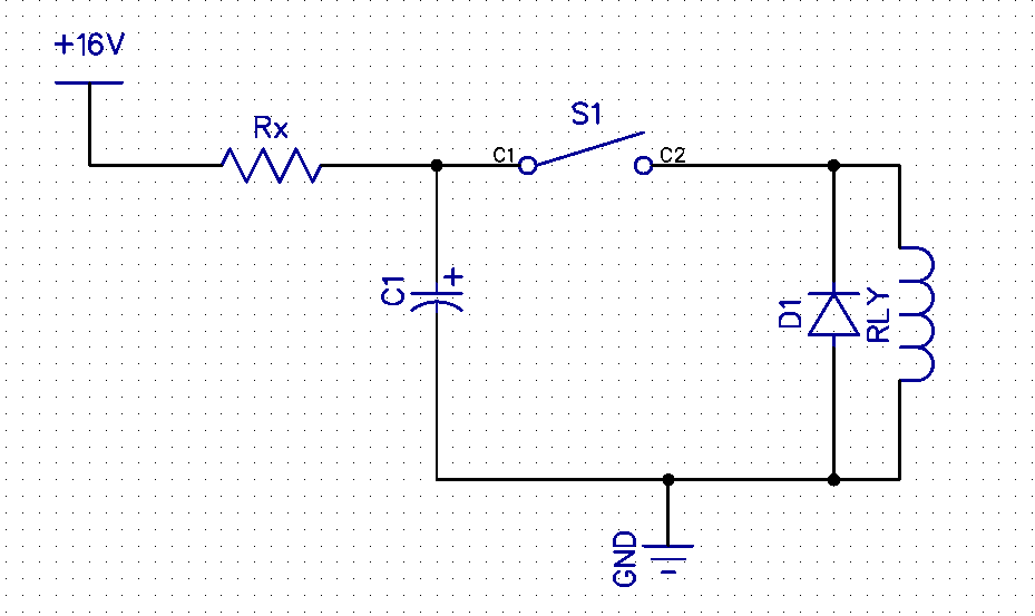

If running form a single 16V supply, you can reduce the power use while holding at 9V by means of a series resistor.
You measure the current at the relay coil at 9V, that is the holding current. From that, you can get the coil resistance. Then, calculate a series resistor for 16V so the current will be the same. You put in a capacitor after the resistor but before the switch, to allow charging to 16V. When switch is closed, you get a 16V pulse to the coil, then current is held at a lower value. This circuit depends a lot on unknown factors, and the capacitor may have to be large. Also, this is not for repeated on/off sequences, but a one-of.
The main advantage here is that the current load on the +16V supply is reduced while holding the relay/coil.
Example circuit:
