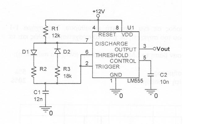

thanks!!! Well while reading i had a trouble once again. An excercise question in an astable multivibrator asks to calculate the max and min current through Pin 7 while timing capacitor is discharging.
Well i thought what means max and min current while discharge and i think it means the moment the timing capacitor starts to discharge from 2/3*Vcc so i calculated Icmax=[(2/3)*Vcc]/R, wherein R is the resistance the cap. discharges through it. Then i calculated the minimum current of pin7 which is when the cap. has 1/3Vcc voltage, so Icmin=(1/3*Vcc)/R
Is it correct or i've just miserably? (Like Homer Simpson says :) )

Its during the tc(L) period while discharging.
Its at its maximum at the start of tc(L) and at a minimum at the end of tc(L).
The discharge current decreases exponentially over that period
You know the values of Ct and Rb so use the exp formula
hi, so i have 2 equations.
The first is when capacitor voltage starts to fall. Imax={[(2/3)*Vcc]/R3}*e^(-t/R3*C1)
and Imin={[(1/3)*Vcc]/R3}*e^(-t/R3*C1)
wherein t=tdc=ln2*R3*C1 ????
This is the circuit

In the original circuit from the d/s, Rb is replaced by R2 and R3, which have series diodes.
D1/R2 and D2/R3 effect the charge/discharge periods of C1, this modification of the periods is often used to change the mark/space ratio of the the output pulse on pin3.
If you look at the d/s for the 555 it shows the equations for timing when these diodes are used.
The maximum current though the transistor connected to pin 7 is determined by current through the resistor between pin 7 and the supply rail plus the current through the resistor connected between pin 7 and the capacitor.
The voltage on the capacitor will be 2/3 of the voltage on the supply rail.
sorry for my late reply, i tried to understand what you told me, but no success. I read the data sheet but i cant find any equations i could use here.
This circuit charges through R1, D1, R2 and discharges only through R3, D2, right? So what are the equations?
