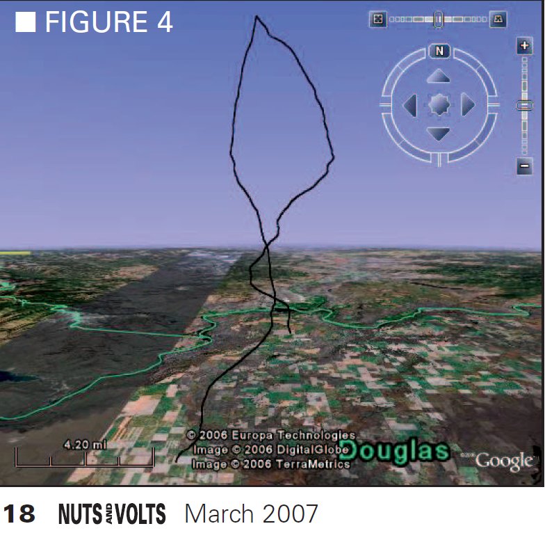

This is probably more than you want but your question reminded me.
Nuts and Volts magazine has a Near Space column about sending balloons as high as they will go with sensors and test equipment. In the March 2007 issue they collected GPS data throughout the flight path with a Tiny Trak 3, and then displayed it in 3-D on Google Earth. A Tiny Trak 3 is essentially a one-way radio modem that you can purchase online at www.byonics.com.
Now it’s time to add the coordinates of the balloon’s path. There’s only one coordinate per line of text and each coordinate is a point in three-dimensional space with the following format: longitude, latitude, altitude.
You’ll get a three-dimensional feel for the flight path as you move around it with the controls.
https://nutsvolts.texterity.com/nutsvolts/200703?pg=16#pg16
There’s a short KML tutorial at https://developers.google.com/kml/documentation/kml_tut
and more complete tutorials at https://developers.google.com/kml/documentation/kml_21tutorial
