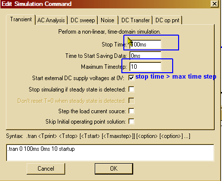

Look at these images... you have tran settings wrong.

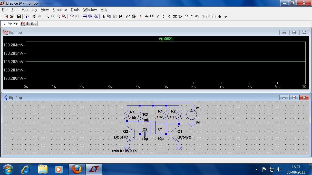

how did it worked ? i used the same transient settings.
i am getting this
i am getting this
Like i said the .tran is wrong
You have a STOP time of 0.1second and a Time STEP of 10 seconds.
Note: the Time Step is the intervals which LTS calculates the plot points.!
so your total Stop time for the plot is 0.1 second and the next interval is 10 seconds later.
The STOP is the length of the Time Axis of the plot.
Do you follow OK.?

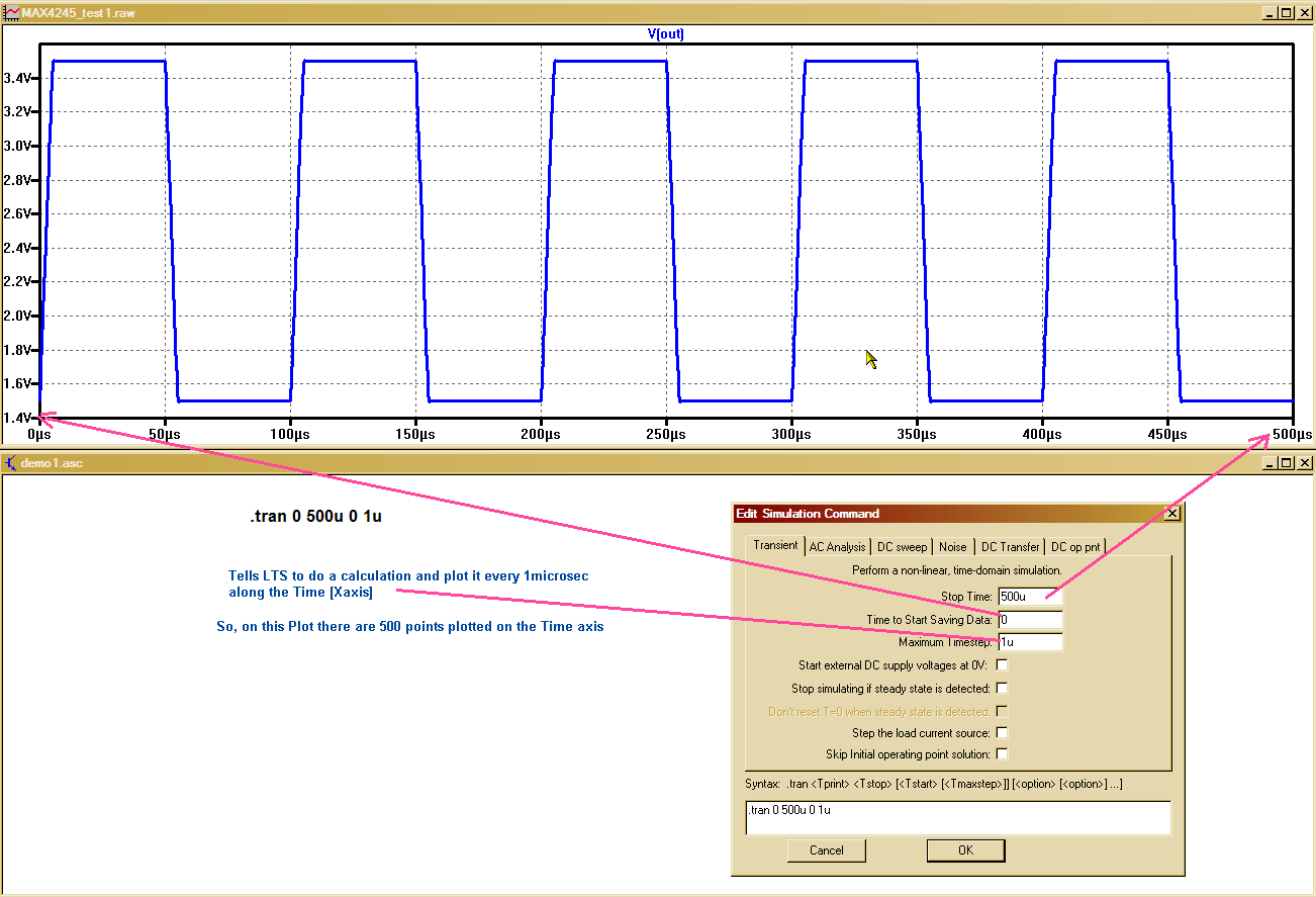

Look at this marked up image.
Use Simulate/Edit simulation Cmd, empty all the boxes in the pop-up dialogue, then just enter 0.3 in the Stop Time box.

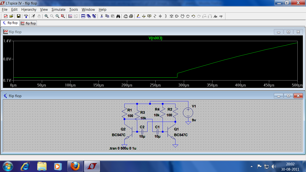

i got this using same settings.
now what ?
  • flip flop.asc
now what ?
Look at the frequency of your bistable in post #2.
Your time axis of 500usec will not show a single waveform...
Make it 1second

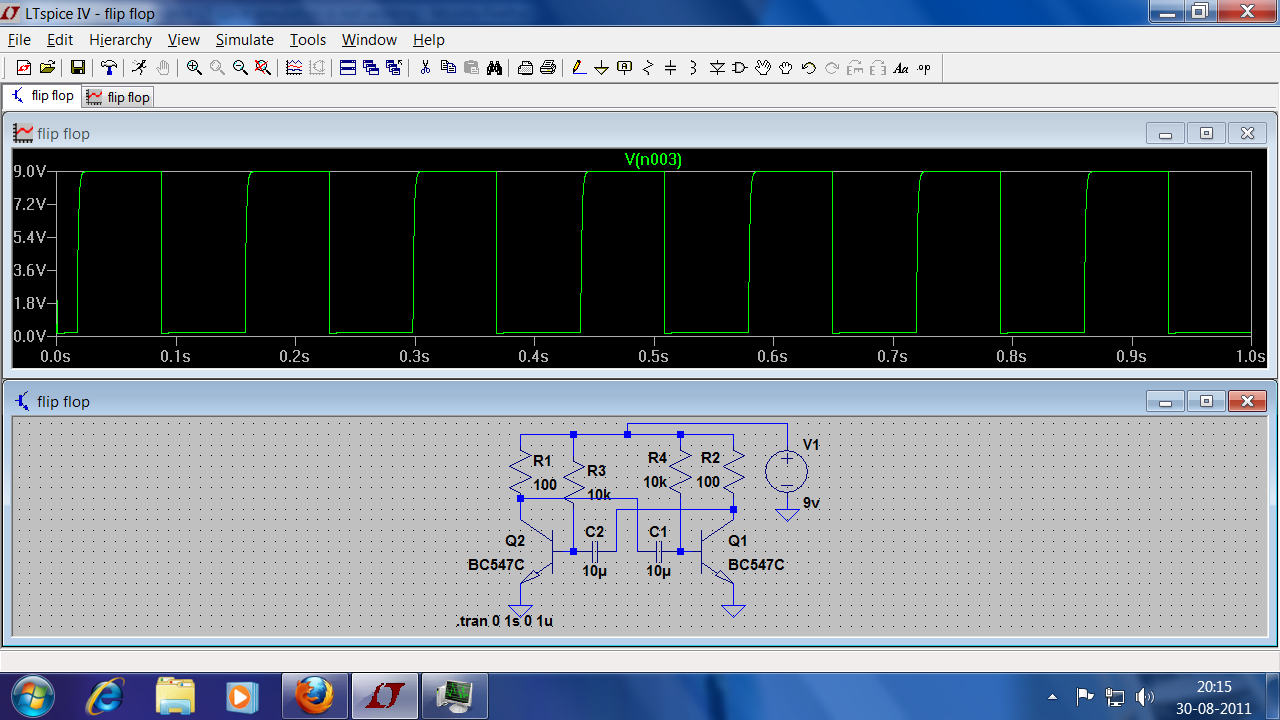

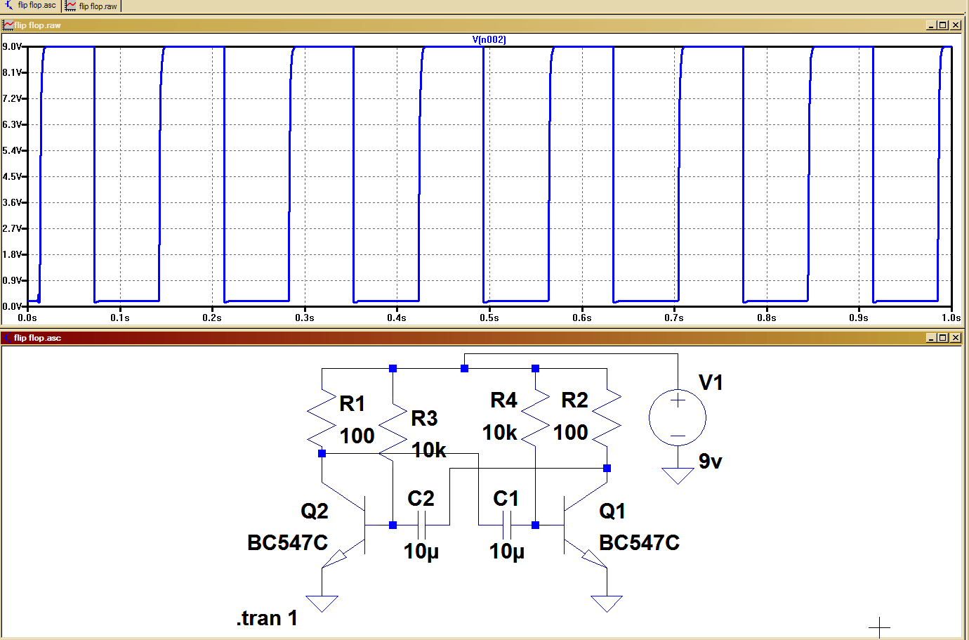

ok now its coming .
but its therotical frequency is something else if you calculate 1/RC But it is showing freq. as 7Hz . ?
ok now its coming .
Thats better.
What do you calculate the frequency should be.??
Most electrolytic caps can have a tolerance of +/-10% or more!
if i calculate it , R= 10K ohm and C= .000001 Farad
1/RC = 0.1s , so Freq. = 10 Hz
thats 3 Hz behind :?
ok , i forgot the formula thankyou
7.29 Hz calculated
7 Hz shown in simulation
