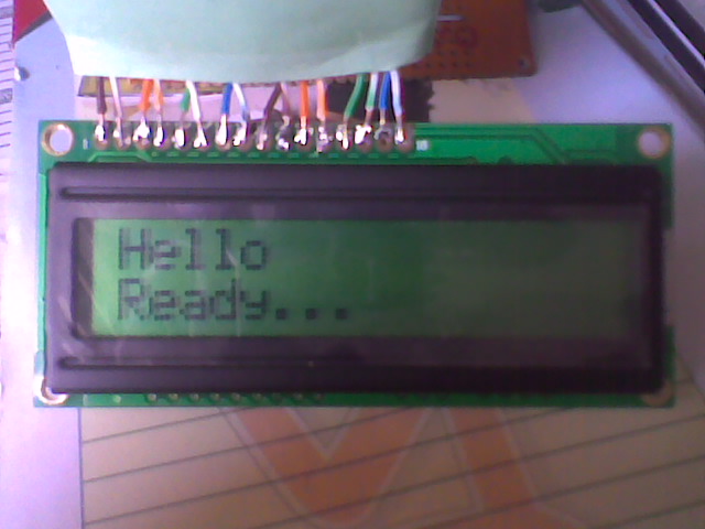

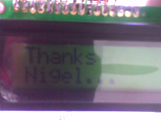

After lost of one LCD module last month. I ordered a new three units, received them and spent one week of attempts to get it work and failed to do so. Today I've good news, my LCD is working.
The reason is me and my Programmer, I'm using DIY K128 PICmicro Programmer, v141204, it sets the Oscillator to IRCIO, so when I press program button, Error massage appears says: " Fuse error 0x2007, Good 0x3D18, Bad )xF18). I used to change the Oscillator into IRCCLK and does not receive any message.
This seem the problem with LCD tutorial, when I left it as it is IRCIO, received the error message but got the LCD working fine.
Attached are some photos of the occasion.
Thanks.
