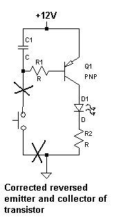

I have one question about it's behavior though. I made this circuit on a breadboard so that I could see the capacitor discharging. The probe was connected where the X's are.
The weird thing is that this circuit would work perfectly fine without the probe in there. When the probe was in there though, the LED would stay on just faintly. And even if the capacitor had drained all the way and the LED was off, if i stuck the probe in there, the LED would come back on faintly.
This only happens when the probe is connected to the scope, and it doesn't matter if the scope is on or off. The probe was in X1 mode.

The circuit that I tested had a 12v supply. 12v through 1M=.0000012A. Definitely not enough to turn on my transistor to turn on the LED.
I attatched the schematic btw.

Hi Zach,
The LED lights with or without the 'scope because the negative-biased base-emitter junction of your PNP transistor is avalanching.
Your circuit is supposed to have an NPN transistor! :lol:
If the avalanching didn't damage the PNP transistor then the circuit will work with it if you reverse the wires of the LED and connect a negative supply voltage at the arrow.

How in the world do you come to that conclusion Audio!?!? If it was an NPN transistor, how in the world would the base be positively biased??
When the NOPB switch is closed, the base becomes negatively biased through R1 as is customary for PNP's. Then the switch closes and the capacitor keeps that negative bias going for a little bit while it discharges.
I made two changes to the picture. GND is where I am connecting the oscilloscope's ground. I also put +12v where the positive supply of my circuit is. Maybe that's where you are confused Audio?
Hi Zach,
Swap the PNP transistor's collector and emitter and it will do what you want if its base-emitter junction isn't damaged by avalanching since it was connected backwards. The emitter of a PNP must always be positive to its base and collector voltages. You drew an emitter-follower and I thought that's what you wanted. I realize now that an emitter-follower doesn't have anything to provide base current except leakage current in the capacitor.
With its emitter at +12V, if the switch is closed then the base-emitter will be forward-biased and the transistor will turn on. R1 will have about 11.3V across it. When the switch is opened, the base-emitter current in R1 will discharge the capacitor until its charge is about 0.6V. :lol:

I'm sorry audio, I ALWAYS forget to mention that. I draw my schematics with switchercadIII and for some stupid reason, they have their PNP transistor backwards!!

Now that the PNP transistor is wired correctly (I suspect it was wired correctly but you simply drew it backwards), let's discuss the problem of the 'scope's 1M input resistance turning on the transistor.
1) Your calculation was incorrect, 12V across 1M is 12uA which is 0.000012A, not 1.2uA. Actually, it is 11.4uA less the voltage drop across R1.
2) The transistor is definately turned on a little since its base-emitter voltage is forward biased.
3) If the transistor has a current gain of 200, then its collector current is 2400uA, or 2.4mA which certainly will light an LED. :lol:
