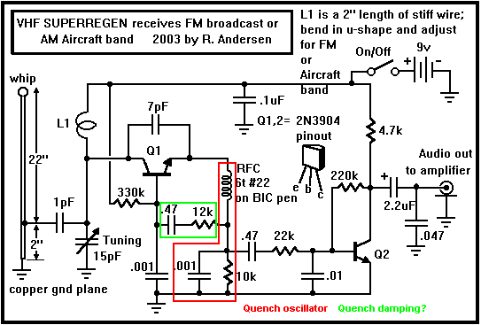

The circuit you started with was a super-regen that had an ultrasonic squegging oscillator built-in. It would ramp up its gain until it began to oscillate and the beginning of oscillation would cut it off so it ramped up its gain again over and over. The "super" parts kept the transistor's gain at max automatically. You changed the circuit so much that it isn't super anymore and requires a manual bias "sensitivity" control like the recent SW-regen circuit you posted.

Hi Ron,
Here is the website that has MStechca's 1st super-regen receiver:
www.tricountyi.net/~randerse/superrgn.htm
I marked its "quench oscillator's" parts and a possible damper for it. If it doesn't oscillate then increase the value of its 7pF cap.

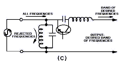

Couldn't I declare the tank circuit in the emitter as a band-reject filter?
Take a look at the picture below. The circuit won't work if you try it (that is obvious).
but it shows how I am using the arrangement shown by tpub.com.
Here is their original image:
Notice how I am using the "band reject" portion connected to my emitter?
and the other two LC components are "band pass". I am using 2 LC components for better filtering, and I am gang-tuning them through varactors.
It would if the transistor is an amplifier, but the transistor is an oscillator so the "band reject" filter selects the oscillator's frequency.
Therefore the oscillator oscillates at its tuned frequency.
They are supposed to connect to the input of another RF amplifier. Your circuit doesn't have one. Where do they connect the band pass RF frequencies to? To an audio amp? To the RF-grounded supply?
Their frequencies don't match because the capacitance of the transistor is across the series one. Each tuned circuit will also have different stray capacitance.

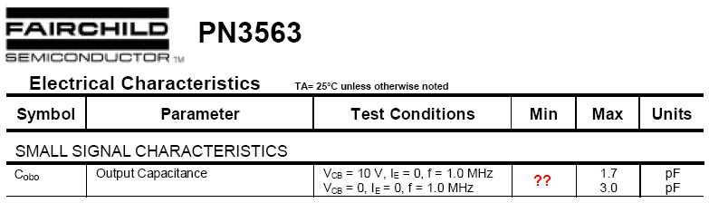

How do I determine the capacitance of the transistor if I were to use the emitter and collector pins?
You must GUESS. They don't have a typical value, they don't even have a minimum value. You probably can't measure such a low capacitance.
