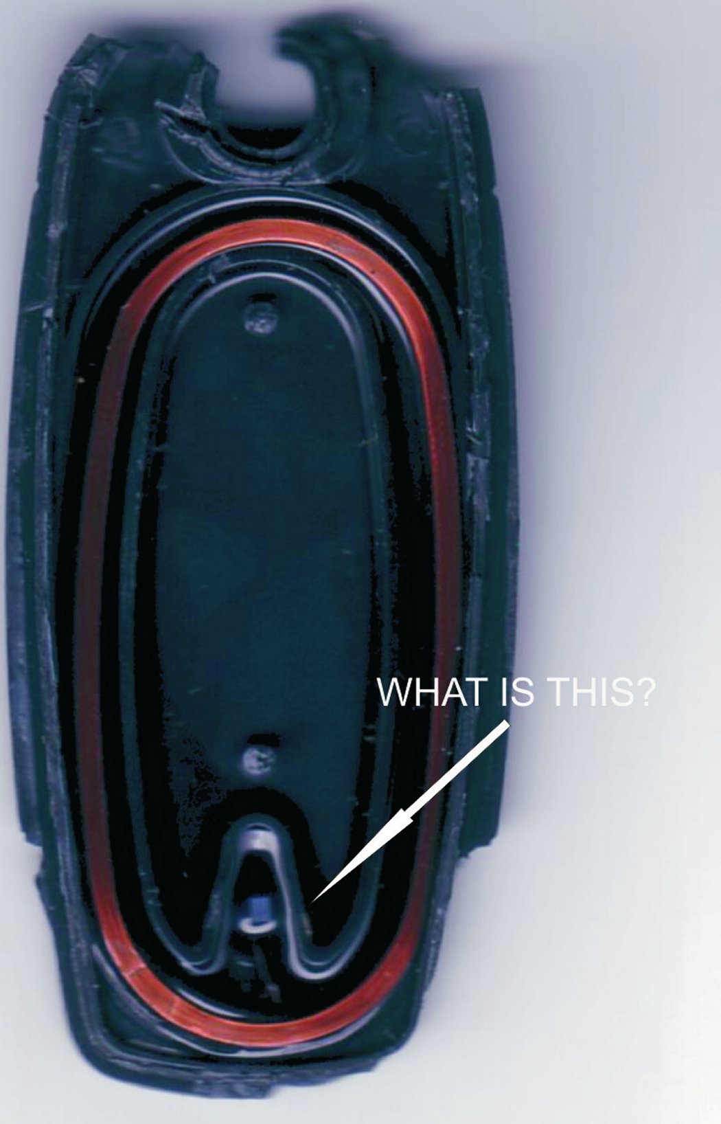

Looking for help identify an object that is used to open automatic doors.
To explain-
My Dad lives in a sheltered accommodation complex.Each resident is issued with a key fob that when put in front of a automatic door receiver opens the door.
Trouble is these are £20 a throw and we have to purchase a number of these in order to open the door when going to tend to our relatives.Each resident as the same trouble where some families spending £60 or so just so they can get in.
I purchased two of these fobs, 1 to get in and 1 to open up to see what worked it.
There is not much at all in the fob only what looks like a copper coil and a very tiny metallic object attached to the coil at two points.
Many of the residents misplace these fobs and subsequently have to purchase more as only one is issed free:mad:.There is no monitoring of these fobs by the council on issue as we can purchase as many as we like for our relatives.
I mentioned to some of the residents the fob might work in the form of a wrist watch and they expressed interest in this thought.
Can anyone help identify this object and if so what does it do?
please see image.
Regards Mark

The image is showing now, hopefully someone will recognise it soon, although it doesn't look particularly clear.
Thanks for that!!
Unfortunately the object is so Small it's very difficult to photograph so I scanned it instead.
The tiny rectangular metallic object in the item in question.It can't be much bigger than 1.5" square. The coil that comes out of it at two points goes around the internal circumference of the case.
There are no signs of any power source to this object
Mark

It looks like a RFID device. Very specific coding inside, I doubt you can get something off the shelf.
If it is RFID,and it looks like it, and if you bought another, it won't work unless programmed into the system. This is how they keep the unwanted out.

Hi HSM
The fob is palced in front of a sensor on the outside of the door enrty point, you just pass it over the sensor and the electro magnet door lock dis-engages and the door is released.

MMMM!!! i'm thinking you maye right here. I googled for RFID and this is what I found-
http://www.technovelgy.com/ct/Technology-Article.asp?ArtNum=1
Does this men it is the end of the line for me in finding a cheaper or better solution? or can they be re-produced? it's a very small chip!!!
Mark
In the link you provided, see Zombie tags. You would need a scanner (Not easy to get) and the tech know how to do this. I think your stuck :(

I guess you are following the wrong trace. A metallic object for access control can't be an RFID chip. It has no conductive areas at all.
An I-Button has conductive areas, one for the data and one for ground. If the object you have to hold inside the receptacle isn't much larger than a PC RTC-battery (dimensions F3-type: 3.1mm, dia 17.35mm; F5-type: 5.89mm, dia 17.35mm) and also looks similar it must be an I-Button.
To use I-Button access systems without any control is pure waste of money.
Each I-Button has a unique number programmed into the chip during manufacturing. For controlled access the ID must be programmed into the control computer to accept a certain I-Button.
The type of the button should be engraved in the housing. Normally it is a DS1990A, manufactured by Dallas/Maxim semiconductors.
If there is no control at all you might purchase a couple of buttons at Mouser or Digitech for far less than you paid until now.

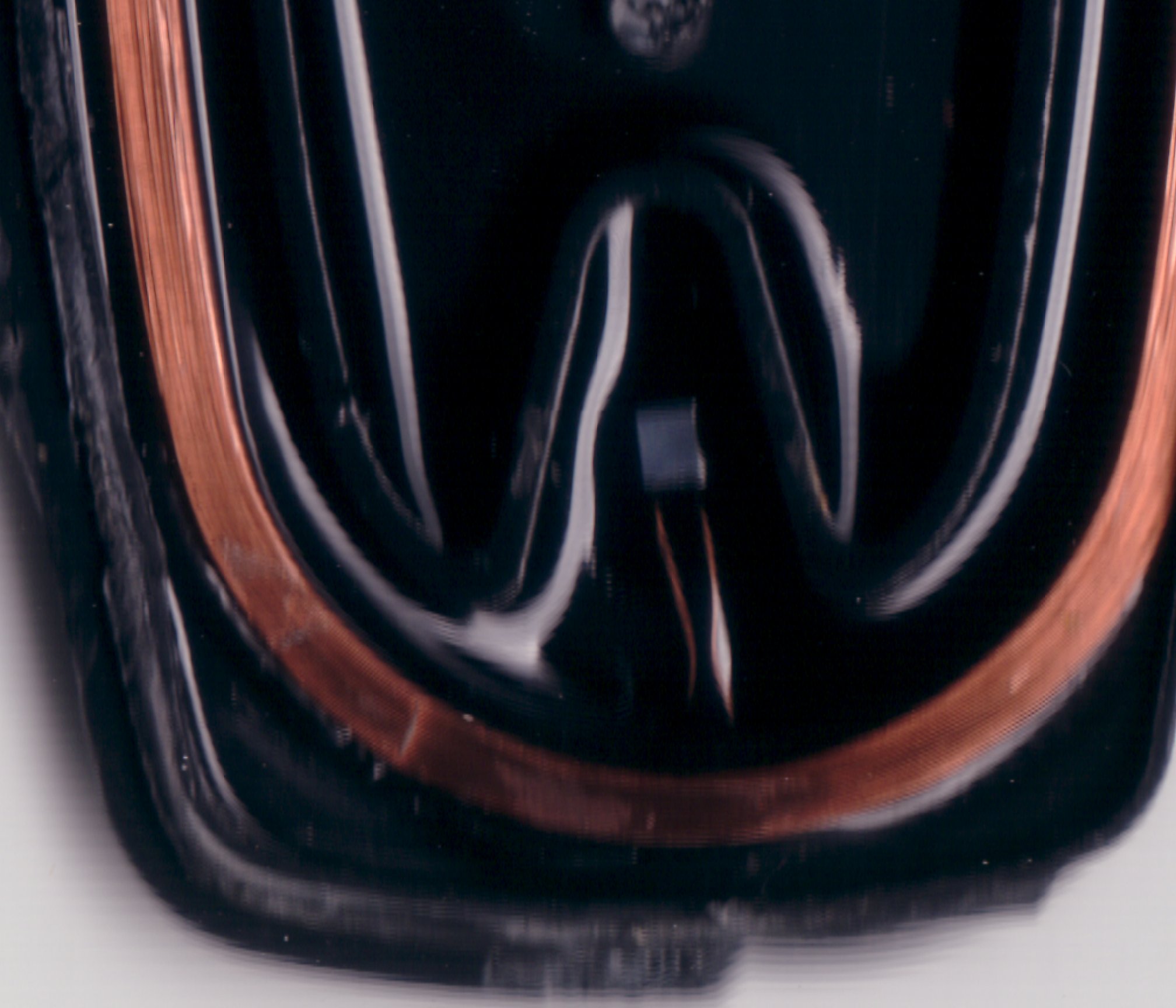

Cheers Boncuk for the info.
I have put in another clearer image of the item in question.
You say it could be an ibutton !! I can see your thoughts on this but on close inspection there are no markings on the surface of the device and I feel as you describe an Ibutton then this device does not match that description.
The device is approx 1.25mm square the device is glued in place so without removing it I can't be sure of it's thickness but I would guess at 1mm or so.
I googled on the DS1990A (ibutton) and it does not resemble this as I see it. none the less the Ibutton looks a great product.
I will still asume that it's an RFID chip until it's shown I'm barking up the wrong tree!!

After further research I am now also convinced that the device as sated a RFID chip.
I will require a scanner/writer to make further "passive tags" These can be purchased quite cheaply.
