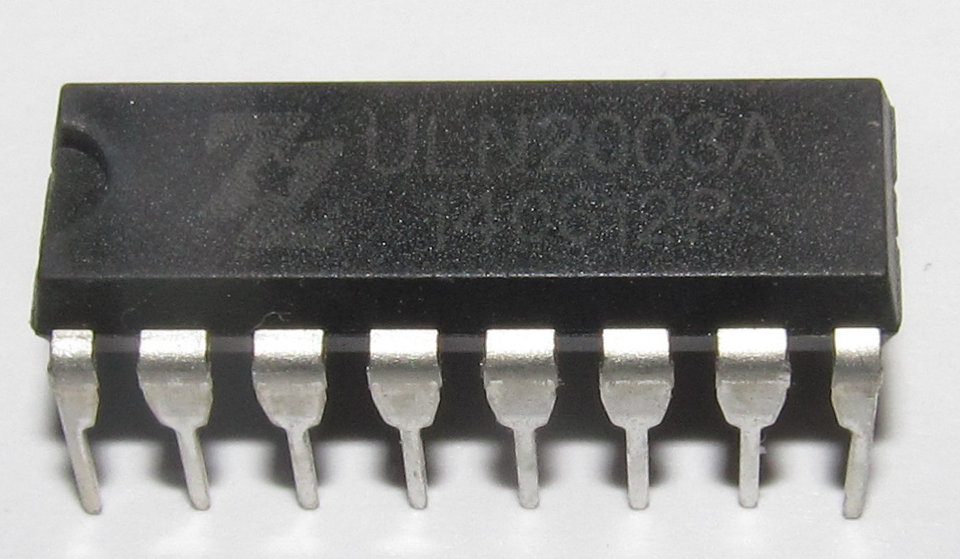

I ordered some ULN2003APG that where supposed to have been made my Toshiba, but instead I got some parts with a logo I have never seen. I googled like mad, searched logo databases and came up blank, anyone know what company these are from?
The logo looks like a 7*L - see attached.

Your distributor should do this. Is there a good reason for being concerned?
It's probably ZZ with the star being the part of the logo for the People's Republic of China flag.
so there.
That is a dead end. They are on my DO NOT USE list.
They work like a ULN2003APG should, I tested a few using a 4W LED.
Then you need to use trusted Distributors, with traceability.
Maybe Zorro teamed with 7 Up :wideyed: or close to. :p
Do you want to re-qualify the parts? There are companies that will certify the performance.
At least they do not have a fake logo.
