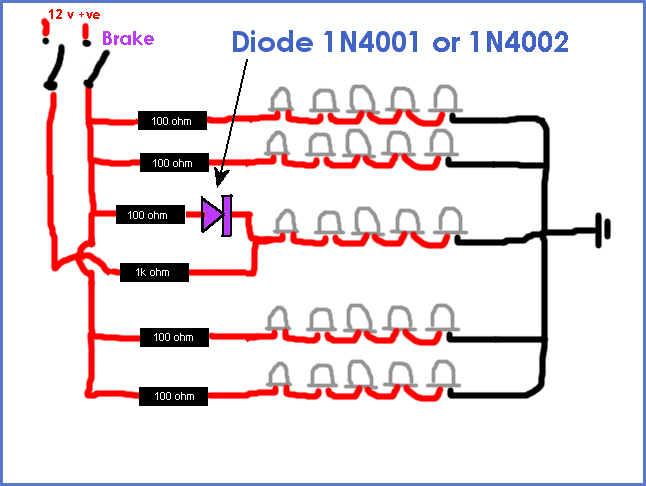

I'm trying to construct some custom rear lights (like alot of other people I see on here), and I'm hitting problems.
This is what I want to happen
normal lights on....
brakes on....
The problem I'm having is that when I simulate normal lights on, all of the lights light up dim, not just the ones I want.
This is how they are currently wired up... (please excuse the shocking skill )
Thanks in advance for any advice offered... or comments on my skillz :lol:
Ant
If you close the first switch, you can easily see that one of the paths for current flow could be as follow.
switch -> 1kohm -> 100ohm -> 100ohm -> 5leds -> gnd
Why not reorganise your switches. There's a master on-off switch, and another switch which is default-on to light up the centre cross?
As per Nigel's suggestion.

Modify the last circuit so that all resistances are more equal. Replace the 1K with a diode, andshort the 100 ohm before the diode already present. put a resistor between the point where two diodes meet and the string of lights. Now make all resistances the same value. Don't go lower than 100 ohms.

Why not just have the middle lights always on, connected to the 12v all the time, and the outer lights connected to the brake?
Thought you have spotted a mistake and doing it your way can save one resistor? :twisted:
The different resistor values are there for a good reason. If you don't get it, go out tonight and watch the brake light when the driver brakes.

You need two diodes to make an OR gate to feed the centre LED's, or even one would do - on the brake light side.
Thanks for all the suggestions guys,
Nigel and eblc1388, from what I have read on various pages, your suggestion will be the first one I try as I believe this will give me the results I'm after.

yes, but he's got 1/4 the LED's for the tail light so that its duller than the brake lights, he doesn't need to make the LED's dimmer aswell...
