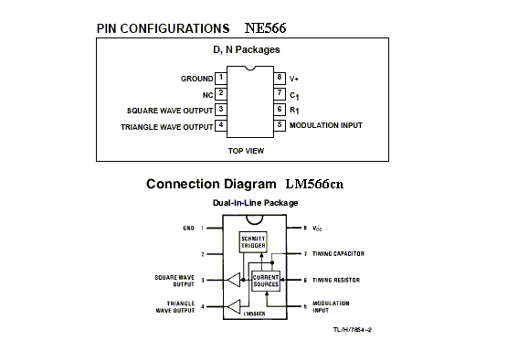

i wanted to know if any knew of a cross refernce for the ne566 or where i might be able to buy old stock. thanks. antonio.

NE566 = LM566

Here is a Comparison of pinouts.
