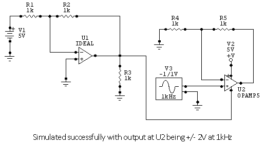

Hi. can I use an inverting op amp with a +5V input to get a -5V output, for use to run other op amps that needs +/-5V? This will be a low current application. Please see attachment.

The answer to the OP's question is NO. An OPAMP can pull its output near -5V IF AND ONLY IF its V- supply pin is tied to a NEGATIVE power supply. You are trying to invent PERPETUAL MOTION :D
Your simulation worked only because your "IDEAL" op amp has build-in internal positive and negative supply voltages. If you use an op amp for U1 that requires external supplies, like U2, you will see that your simulation will not work (as would be true in real life).
Without seeing the schematic we are just guessing. I don't know why the schematic is hidden in a zipped Word document.

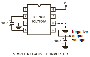

An ICL7660 IC charge-pump IC can do it but its output current is low.

Anyway, here's the schematic in PNG format, goodness knows why the OP didn't just post it in PNG in the first place.

Just looked at the schematic again, it doesn't look right to me. Why is the 0V of the second op-amp connected to the output of the first?
If it's to bias the AC voltage at a certain DC level, it isn't the right way of doing it, a potential divider should be used.

Just looked at the schematic again, it doesn't look right to me. Why is the 0V of the second opamp connected to the output of the first?
Post #6 says that the "ideal" opamp for the first opamp has a positive and negative supply so its output is -5V. Then the second opamp also has a positive and negative supply.
Lol, I can see what the original poster's done, they're using an ideal inverting amplifier with a built-in negative supply to get a negative rail for a non-ideal op-amp. :D
This will never work in real life because a real non-ideal op-amp will require a negative supply and so will an LM7905.
