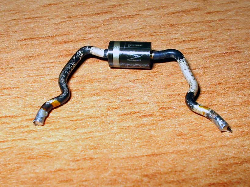

the diode is D206.
I think it is the damaged component becase it is look like a diode and when I check it with DMM it measured me 0 ohm on both directoins.

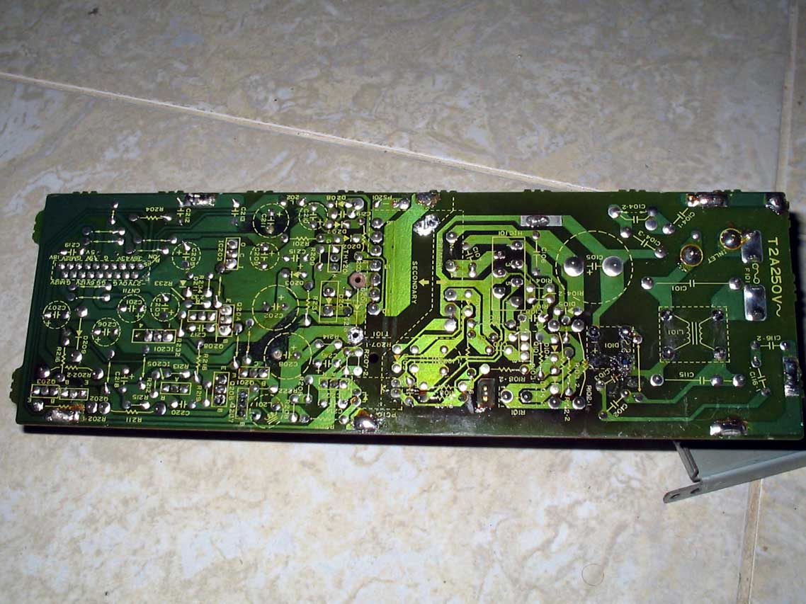

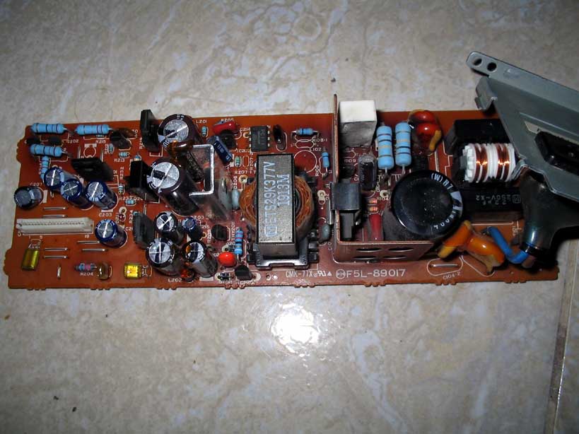

does it's PCB help you? I don't have a circuit. :(

Yes, it's a rectifier diode. The chances of finding an identical one, or identifying this one, are probably very slim. As a service engineer who repairs VCR's I would replace it with one I had to hand.
It's a fairly substantial rectifier, and (as it's a switchmode PSU) it will be a fast recovery type - I would suggest looking for a fast recovery rectifer rated about 5A. I'd probably use a BY299 - because I've got them in stock!. If you've got a choice of a number of rectifiers, pick the fastest one, the faster they are the cooler they run!.
It seems to be an old Shindengen part number, and if so, it would make it a 3 amp, 250nS fast recovery diode. I would seriously suspect the capacitor it is feeding, I think it's C208 ( ? ) the large electrolytic that is connected to the diodes trace on the PCB. I bet that cap has developed high ESR or has become leaky, overloading the diode. Electrolytics tend to go bad after awhile, and it is common for them to destroy a feeding diode when they do.
Without an ESR meter, it would impossible to tell if the capacitor is bad or not. I would just replace it. For the diode, if you have access to either ECG or NTE replacement parts, it could be replaced with ECG or NTE #580 or regular parts such as a MR852 or a BYW95B
There appears to be some heat damage to the PCB, so check all the solder joints too.
i agree , in the last photo the upper pad to the diode seems to be missing ,or it is just the angle of the photo that makes it look like that.
but it appears to be bare PCB in that spot

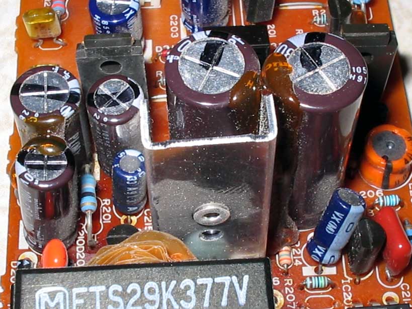

the capacitors have a glue on them to hold them in place and provide som mechanical support. The large ones on the right are the ones that I suspect are damaged.
