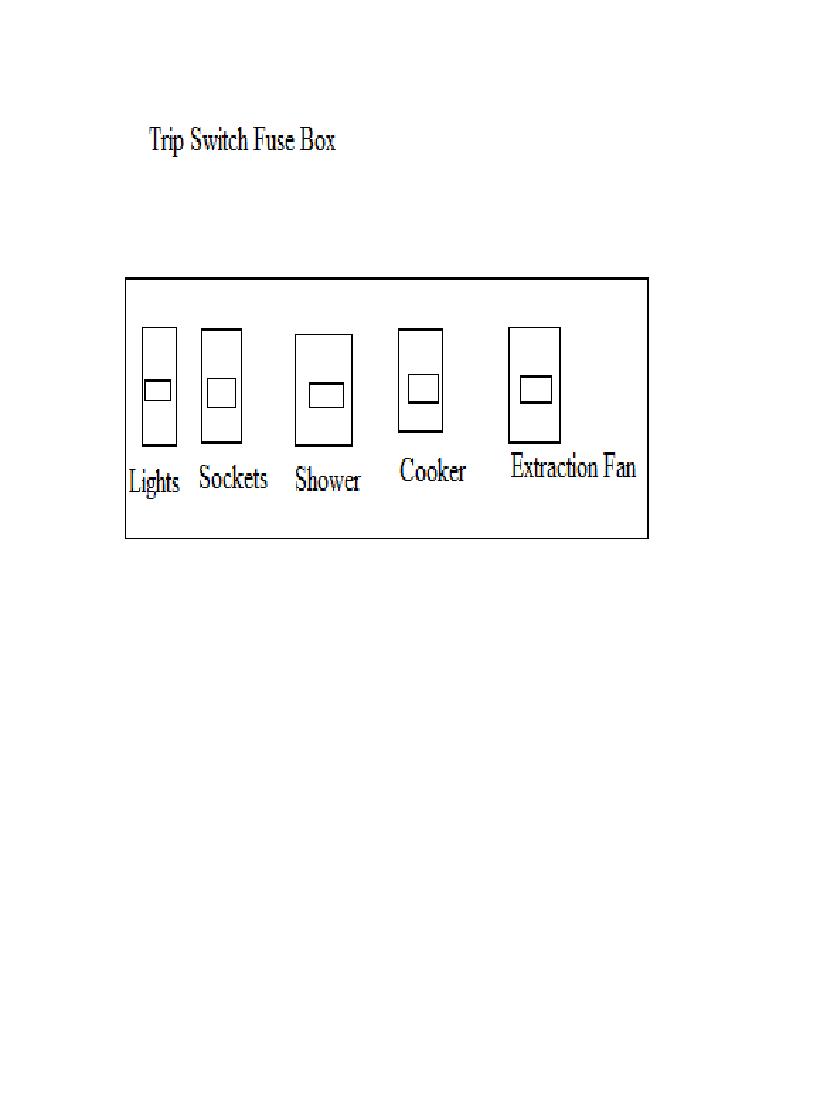

Fuse Box have trip switches if that helps

The Fuse Box have trip switches which are very sentive if you just touch an earth wire and it trips the device that it is connected too
It sounds like you're talking about an RCD which cuts off the power when some of the current leaks to earth.

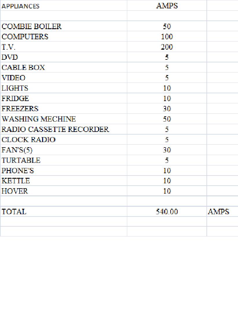

Generator sheet
Have enclosed a sheet of all devices in my house and the Amps that they use if it is wrong please let me know.
Also seen a generator that had 2KVA was wondering if that generator would do all my devices in my house?
Thank you for all your comments
Sorry, but your list is completely useless - you've mixed amps and watts together - many items on that list (like the kettle and washer) individually use more than a 2KW generator can provide.
Hardly anything on the list makes any sense.
5 amps for a clock radio :eek: I run a 2400watt sinewave inverter on our house and unless I have another phantom load on the inverter will switch on and off resetting the clock all the time. Mind you I have the inverter trip point set to the mininum which is 30mA and the clock doesnt even use that much. So if your clock is using 5 amps I'd be looking for a new clock radio.
Anyway to measure household items you need a watt meter and siliconchip did a project on one sometime ago and i wouldn't be surprised if EPE has done it too.....
Cheers Bryan ;)
50 amps to run a washing machine? It is 1/4th our service here! :eek:
Where on earth did you get a washing machine that takes 50 amps!?
