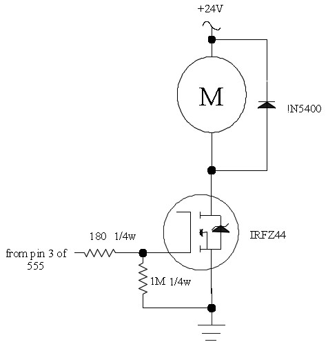

Here is what i am trying to do i want to turn a dc pump on and off faster then 1 second intervals. Basically this is being used to create waves in a reef tank. I have found people doing this with three wire tunze pumps but i have a 2 wire resun. I have built 2 types and they have both failed. I don't know if it is because the pump draws 1.5 amps and is 24 v dc.
Is there a good article or better yet a video on how the 555 timers work? I see people making leds flash with them so i should be able to get this pump to turn on and of right? The first one i built was this but could not get it to work i am not sure where my positive and negitive in and out go.**broken link removed**

With the diagram you posted Pin 1, is the output,Pin 2 is the - supply, and Pin 3 is the + supply. Most 555's have a maximum supply voltage of 18V. The 555 will not drive the motor directly, but it will drive a power mosfet to turn the motor on and off.
Ok I looked up power mosfet and it looks to me to be kinda a relay that can come on and off quickly. Is this right? anyone willing to help me design a circuit to get this to work? I would really appreciate it and my Corals would too. I want to make this work there is a lot of people out there that would like to figure out how to build this.
I am not sure what you mean there is no pin 3 there is 1 2 and 5 So what is the output + or -? I would assume it is positive with the cap going across it right? This pump will run at 12v and the power supply is adjustable so maybe i will rebuild it and try it at 12v for starters.
With the diagram you posted Pin is the output,Pin 2 is the - supply, and Pin 3 is the + supply. Most 555's have a maximum supply voltage of 18V. The 555 will not drive the motor directly, but it will drive a power mosfet to turn the motor on and off.
It's not just suggested, but needed. The amount of current a motor draws is magnitudes greater than what the chip can supply. You need the mosfet to act as a high power switch that is controlled by the 555 IC.
So what one would you suggest and how would i add it?
Please see my original post for some corrections.
I would recommend and IRFZ44 n channel mosfet, and suggested circuit is posted.

Now draw a 555 as a schematic - not as a "layout" above - so you can see how the chip is operating, and add the MOSFET and motor section (as shown above).
I can then comment on your circuit.
