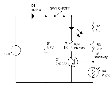

My first try???
Any ideas as to how well this might work? Or if it will at all?
Questions:
1) Should the max voltage of the solar cell (in fun sun) be no more than the battery voltage (3.6V)?
2) If so, could replacing D1 (1N914) with a 3.6V Zener diode regulate it?

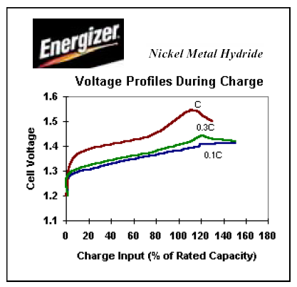

Ni-MH cells are charged with current, not with voltage. The voltage from the solar cells after the 0.7V drop by the diode must be high enough to supply the charging current, about 1.4V per cell x 3= 4.2V + 0.7V= 4.9V minimum.
Energizer recommends reducing the trickle-charging current when the battery is fully charged. The fading sun and clouds will do it for you.

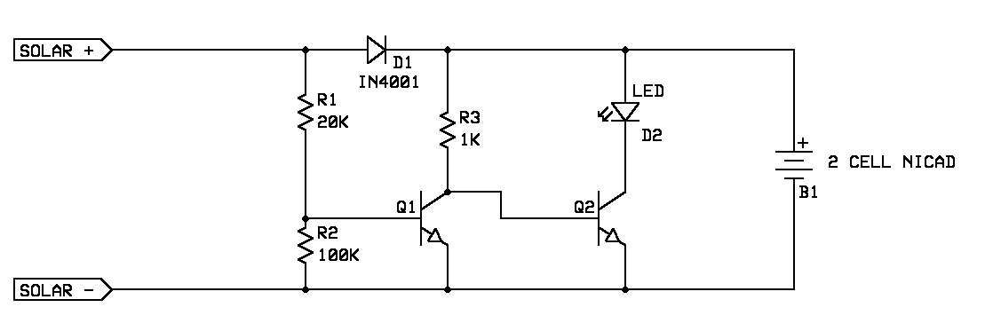

Here is a circuit from a commerical solar moonlight. It uses the solar cell to sence if it is dark/light and controls the on\off switching of a Yellow LED. Notice there is no current limit resistor for the LED. In the interest of utimate cheapness, the manufacturer relies on Q2s beta and R3 to limit LED current. I've posted this schematic to point out how to eliminate the CDS cell from your circuit. For the transistors you can use 2N3904s.
On another note, NIMH batteries are a poor choice because they don't like to be over charged whereas NICADs will tolerate over charge much better. The NIMHs will overcharge in a bright area (Or Summer) if the circuit is optimized for dimmer (Winter) conditions.
