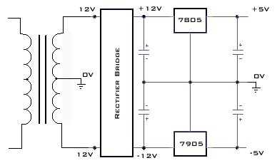

Would something like this work, I need +5V,0,-5V, 300mA?
What would complete the circuit to make it even better?TIA.
What is the current you are looking at?
Do you want a fixed output of 24V or vairable up to 24V?
LM317 is a variable positive voltage regulator.
If you want a fixed output you may use 7824 (positive) and 7924 (negative) voltage regulators in the ckt suggested by GTO. In that case the power transformer should be capable of supplying the required output
(current & voltage). The regulators needs minimum input voltage of 27V to sustain stabilistion.
