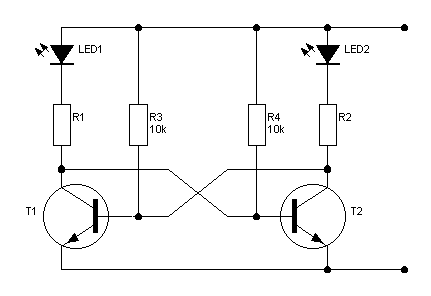

i need a circuit with 2 switches, so when you press switch A, LED A comes on and LED B goes off, then when you press switch B, LED B comes on and LED A goes off. whats the easiest way to make this?

Here's a quick bistable I've just drawn, you can fit the switches in a number of ways:
1) From the base of the transistor to the emitter, in which case pressing the key down turns that transistor off, and lights the opposite LED.
2) From the collector to the emitter, where pressing the key down turns the other transistor off, and lights it's own LED.
The main difference is what happens if you press both switches together, with option 1 both will go out, with option 2 both will light.

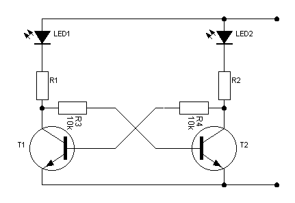

i cant get it to work. when i press button A, LED A comes on, press button B, LED B comes on, press both, both LED's come on. av tried it connected all different ways. what am i doing wrong?

Very sorry! - I've had a momentary loss of brain! - I drew a circuit half way between an astable and a bistable, try this one instead.
Luckily no body noticed :lol:
