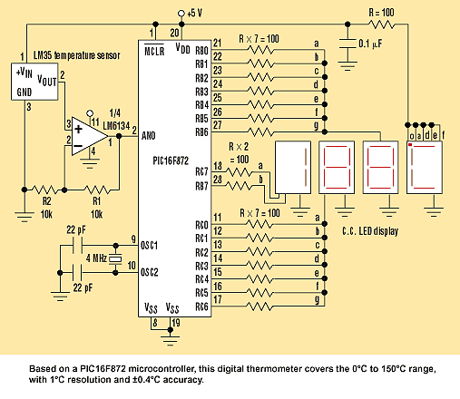

Here's one scheme using PIC 16F872 and a display.
The full link of the above article is as follow. The source code for the PIC is available for download too.

The original poster asked for a "thermostat" to "Control" the temperature. The suggested circuit only measures the temperature.
True. With the source code available, and the existing temperature measured, one only needs a few PIC instructions to turn ON/OFF the heating source.
I not tested the code because i usually do my code... but i already used PIC16F872 in other projects and i think that's very good! A few instruction will control the heating source :lol:

I have two suggestions if you want SIMPLE:
1. A mechanical thermostat
2. An inexpensive digital temperature conroller with ON/OFF capability
