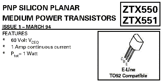

I see the ZTX550 as NOT an equivalent.

The pin designation for a 2SA1015 should be ECB
[emitter collector base] looking at the face.
The problem with the ZTX550 is the pins are EBC.
Otherwise it's characteristics are similar.
You could try twisting the legs of the ZTX to fit.

Here is some crop from original datasheet...
