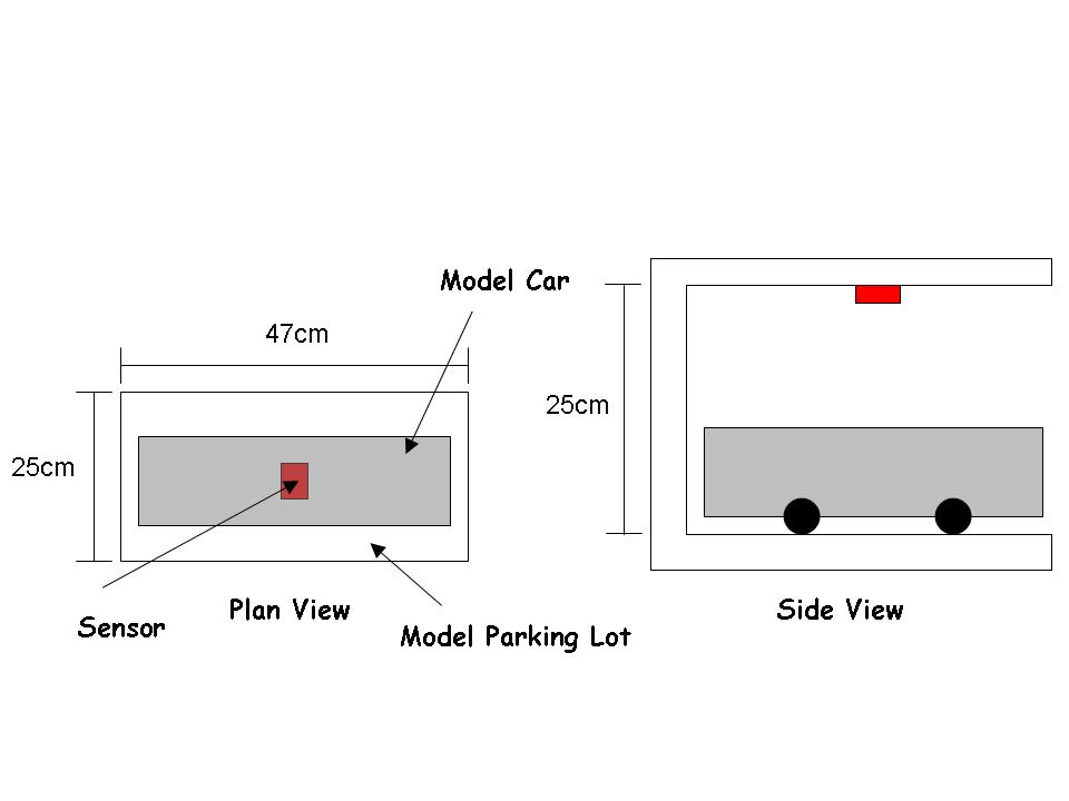

I am doing a project on reserved parking lot monitoring system & I will be making a model lot & using a model car to simulate how this system works. When a car parks at the parking lot, a sensor mouted in the center & on ceiling above the model lot, will detect the model car trying to park the lot. I am not very sure what type of sensor to use & where to buy it. I attach a picture with the dimensions of the model lot. Can ayone help me? Thanks in advance.

The real implementation will need to sense distances of a couple of meters right? From top of smallest car/motorbike to the ceiling which is a couple meters higher up yes? That rules out alot. Ultrasonic might be able to work at that range. Sounds expensive for an entire lot fitted with these things.
Why ceiling? why not in the deck like sensors do at traffic lights? inductive loop or RF under the vehicle? Or weight sensor?
For just the small scale model, you could use ultrasonic at up to a few feet range or even IR for smaller distances (& probably the easiest to get working the web is full of design examples, go look)

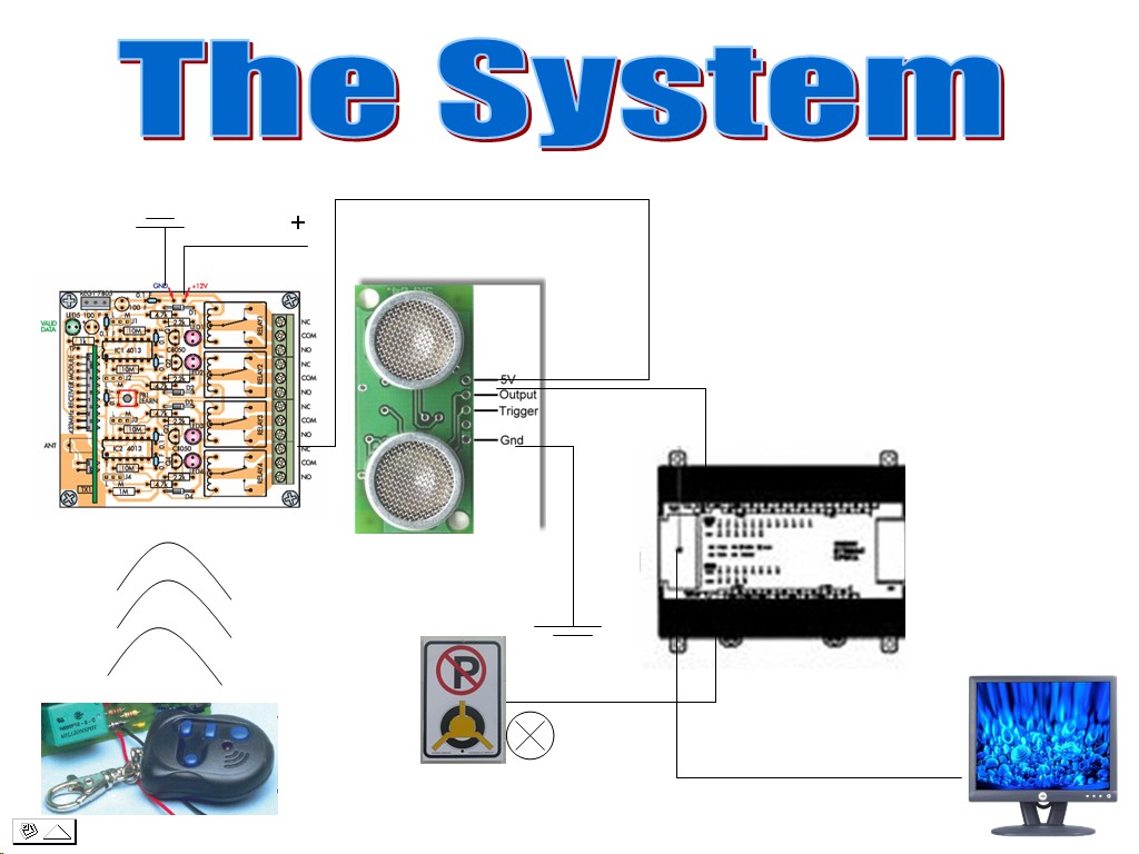

This is how the system looks like.....but I am not sure whether the sensor(SRF04) will be able to interface with a PLC(Omron CPM1A). Also, I dun know where to connect the trigger. I am using PLC because I have no knowledge on microcontroller & i dun have time to pick it up now......

interfacing SRF04 to plc is quite difficult. not much because of signal level
but because of timing. since you are using plc,
i would recommend industrial sensors. maybe small photoeye
will do the trick? you could place piece of reflective tape on the floor
and put something like E3Z-R86 overhead like in your drawing.

Thanks for ur info.....U mean difficult because of timing but can it be done?
difficult <> impossible
read the spec of the sensor. do you know how to match levels?
after this is done, you have to look at timing. (read the spec again,
there might be need for external circuit to match the timing too).
then read the spec of your plc. you will see that i/o is slow.
inputs usually have response of 5-10ms. outpus are
also limited b scan time which for plcs is in the ms range too.
high speed inputs are optional. most small plcs come with few
fast inuts (2-6) which are suitable for counting for example.
they are NOT suitable for much more since the plc logic is
normally scan time limited. doing more than that is possible
but it requires advanced skills (interrupts just to name one,
direct i/o access etc.). most people working with plcs for living
would find it way to dificult. you WILL BE over your head, trust me.
this sensor was designed to be used with MCUs. if you want to use PLC,
use sensors that work with PLCs. the one I mentioned costs similar to
SRF04, it's 10 times smaller (ok, it's 8x smaller) and it's 10 second job to wire it to plc.
