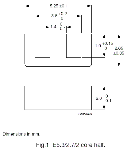

I'm sure You can find an equivalent type.What is the manufacturer?
The gap = air-gap need some application to avoid saturation of core.
If the core haven't air-gap You can make it, but if have, and for application no needed = problem...
Hello,
The manufacturer is philips semiconductor.
Btw, how do we differentiate the e-core which is ungapped?
Is the center part of the e-core shorter?
Pls advise.
Thanks so much.
Yes, the center part is shorted.
What mean "BTW"?

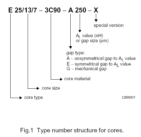

As i see, this is an order-number, but i can't find anything. I have a catalog from about Ferroxcube (this is Philips product-name).
See this type-numbering maybe help.
