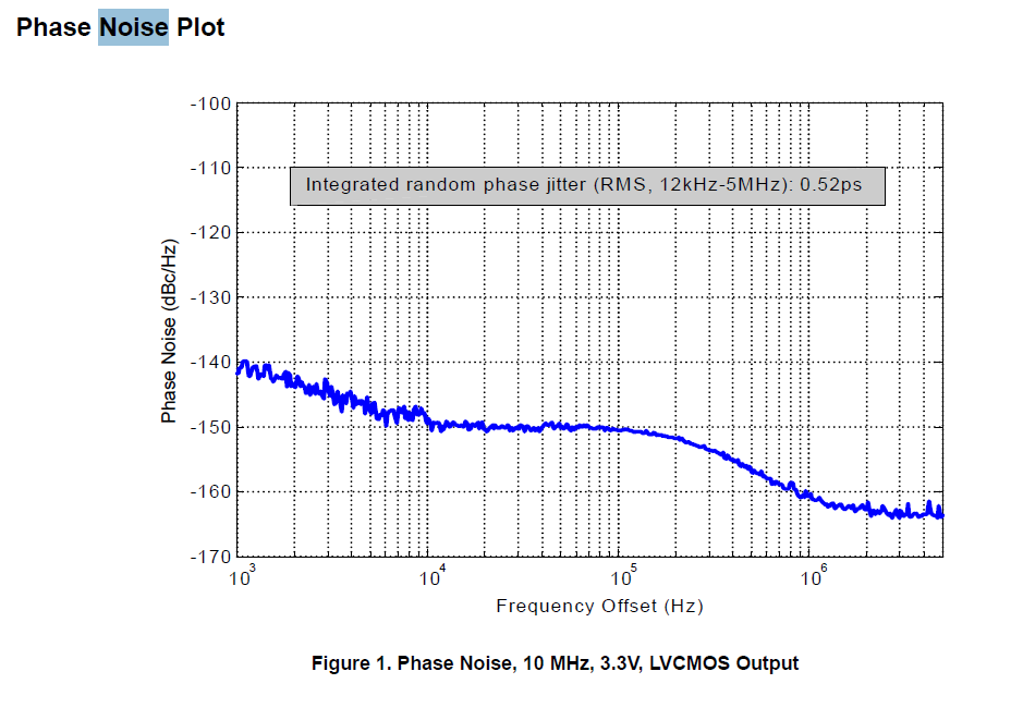

I don't know how accurate is accurate or how low is low, but the Digikey will program an SiT8208 (a 20ppm MEMS oscillator, not a crystal) and you can specify the frequency to 6 decimal places.
https://www.digikey.ca/products/en/...a9&quantity=&ColumnSort=0&page=1&pageSize=250
EDIT: Actually maybe not. You said RF carrier so that means you need a sinusoid right? This is a square wave device.

The part chosen by dknguyen is better in performance , but is a 3.3V programmable XO. ( internal fractional N PLL)
MEMS OSC have higher Q's than typical AT cut XTALs. They are superior mechanical, non-piezo effects, better thermal, EMI, Phase noise. Field Programmable.
Consult with Digikey Tech support about getting either the XO or VCXO for your frequency.
There may be a learning curve otherwise. https://www.digikey.com/en/supplier-centers/s/sitime
Since you have a 9th order harmonic oscillator, , the XO needs to have harmonics ( e.g square wave)
It has far superior phase noise, more than adequate tolerance and stability.
Just order the frequency you need for 3.3V and interface with an LDO and series cap or R as needed to inject 9th harmonic.
