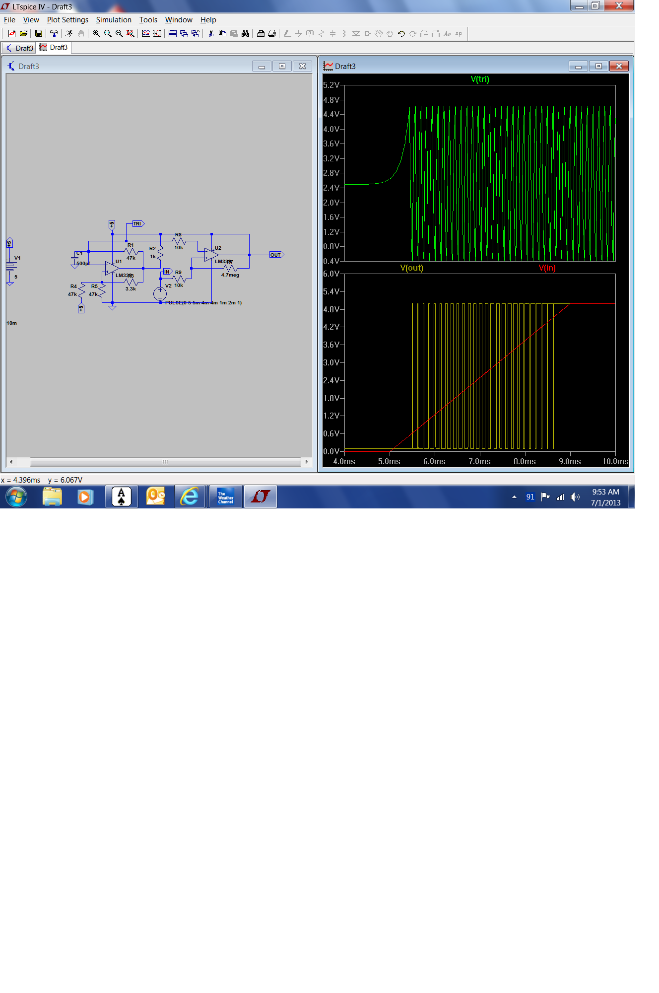

how can I generate PWM signals (w/o a microcontroller if possible) from a variable dc signal (0-5v) to drive an H-Bridge?
Is there a IC that I can buy that will do it?

Or here is one using a comparator.
