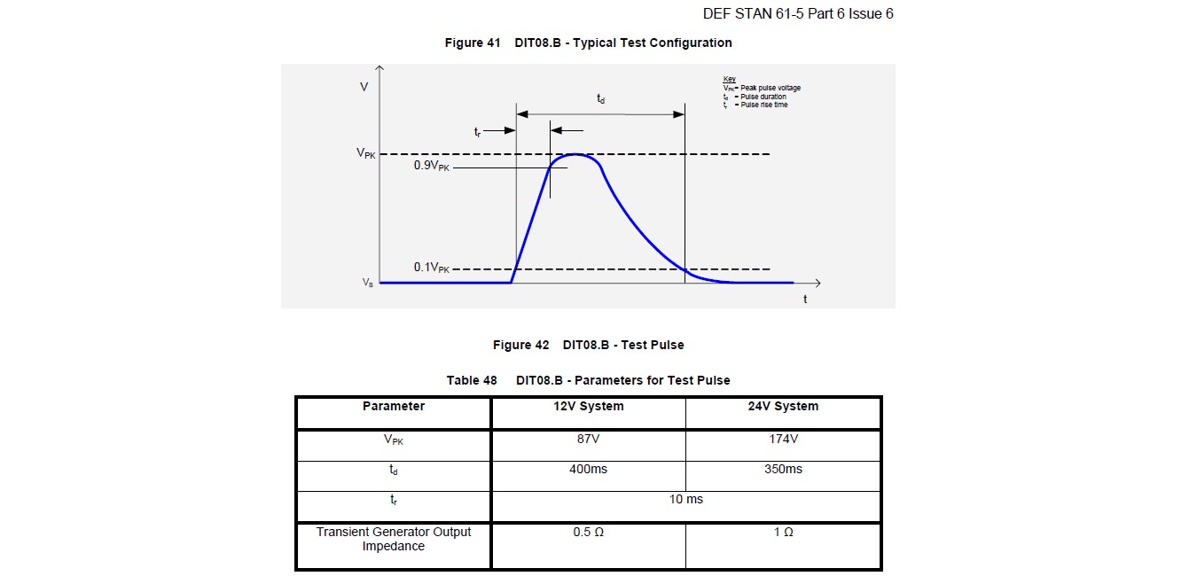

Just now found out that our 300W converter, (10-36vin), must also keep supplying 300W throughout the attached load dump surge aswell...
I believe you would agree that this needs us to boost up the input voltage to 175V, and beat the surge like that?.....
So i believe we need a triple cascaded boost converter...and three of those in pllel, at the front end...then we beat the surge!.....we dont even see it...because our effective vin is now above the surge!

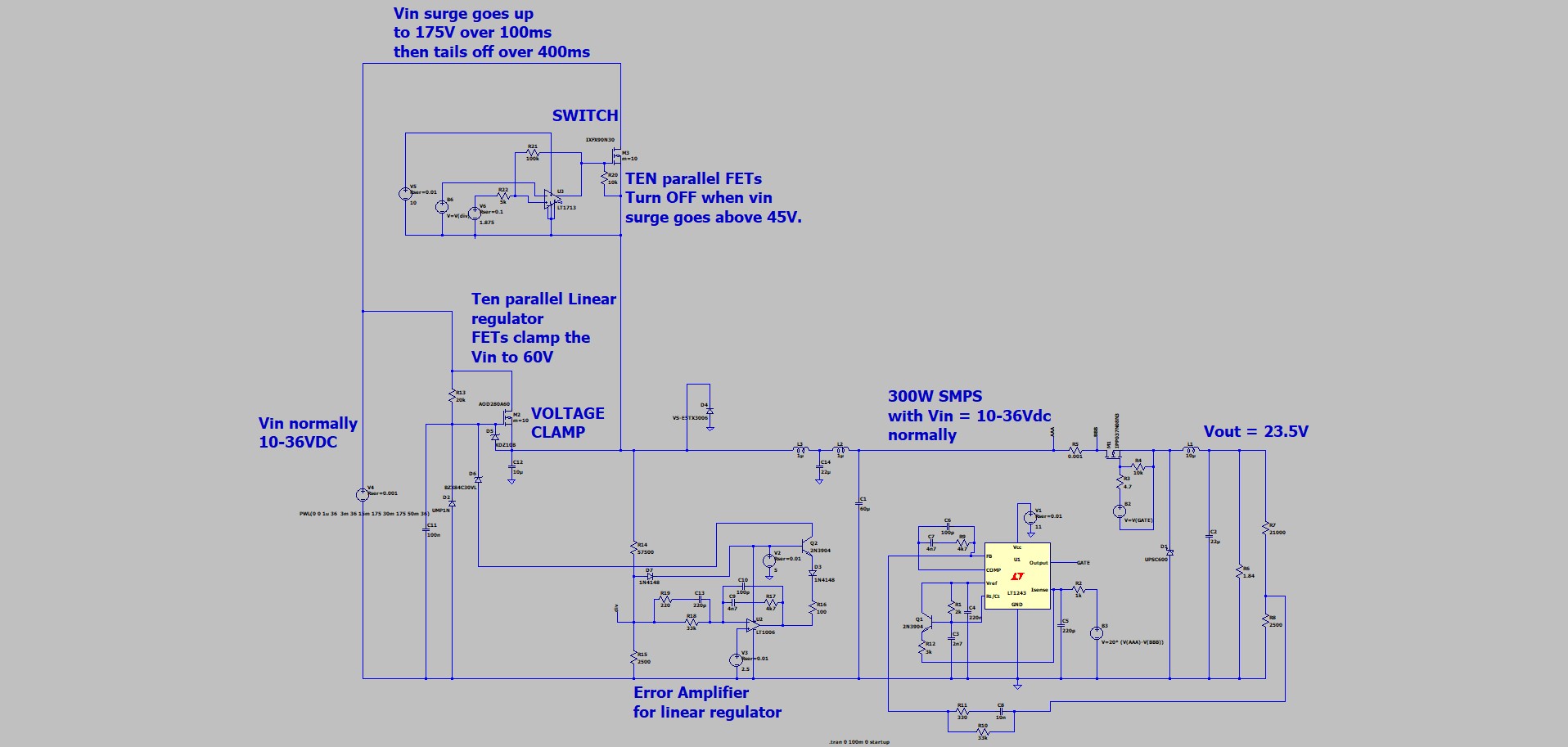

The attached shows a 300W SMPS (LTspice and pdf) with nominal vin of 10-36vdc, being protected from a 175VDC surge.
Just uses a linear regulator. (voltage clamp)
Do you think its OK?
(though think will have to make 10 separate linear voltage clamps , each with a clamped maximum current,to prevent current hogging)

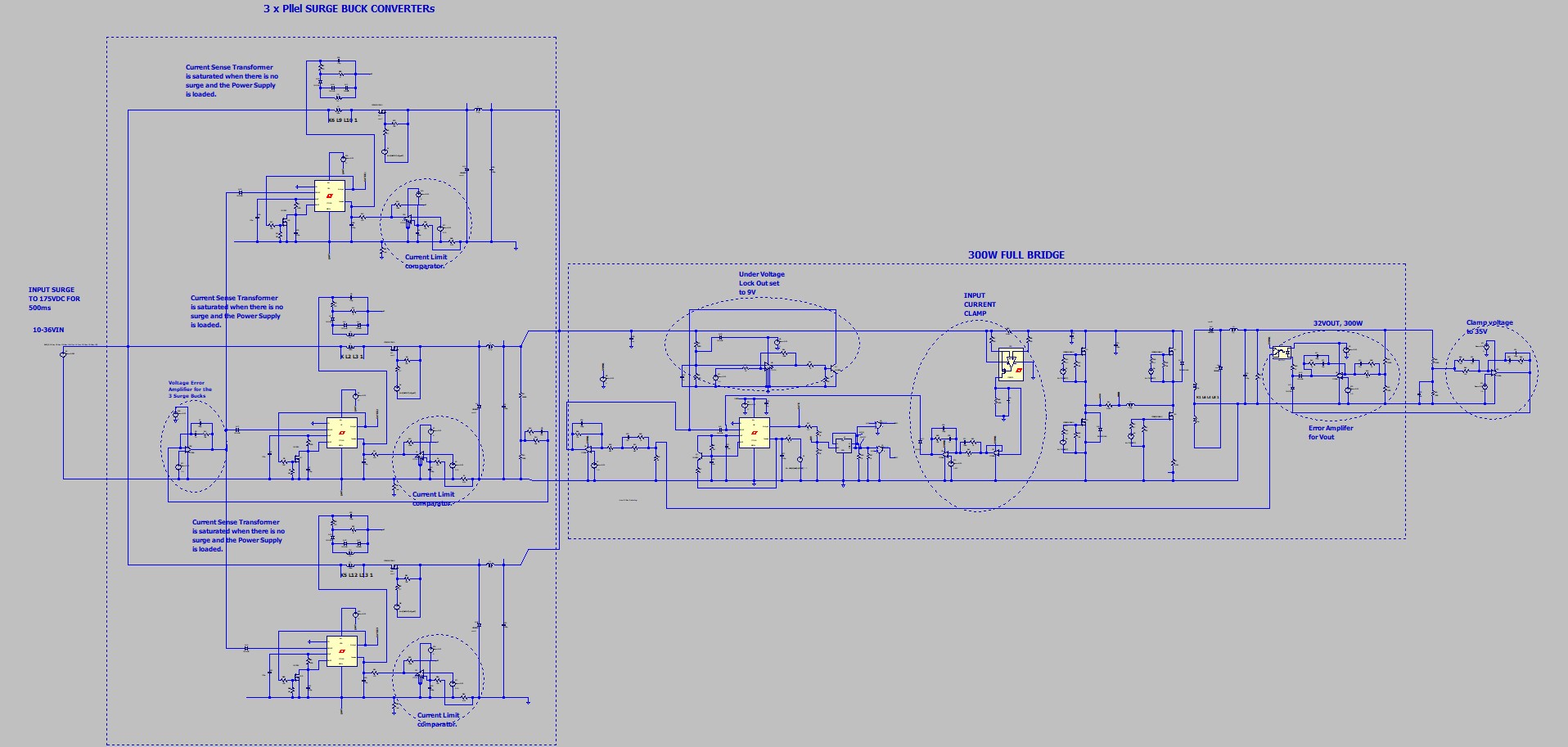

So, The attached is the most pathetic thing you will ever see in the world of SMPS....its a Full Bridge for vin=10-36v, vout = 32v, pout = 300w.
BUT
The input has surges to DEF STAN 61-005 which means Vin sometimes goes to 175vdc for 500ms and the converter must be able to provide 32v and 300w throughout this.
So the three Surge Buck converters as shown are pretty well the only realistic way of handling the surge...but just look at the heaps of components!!!

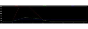

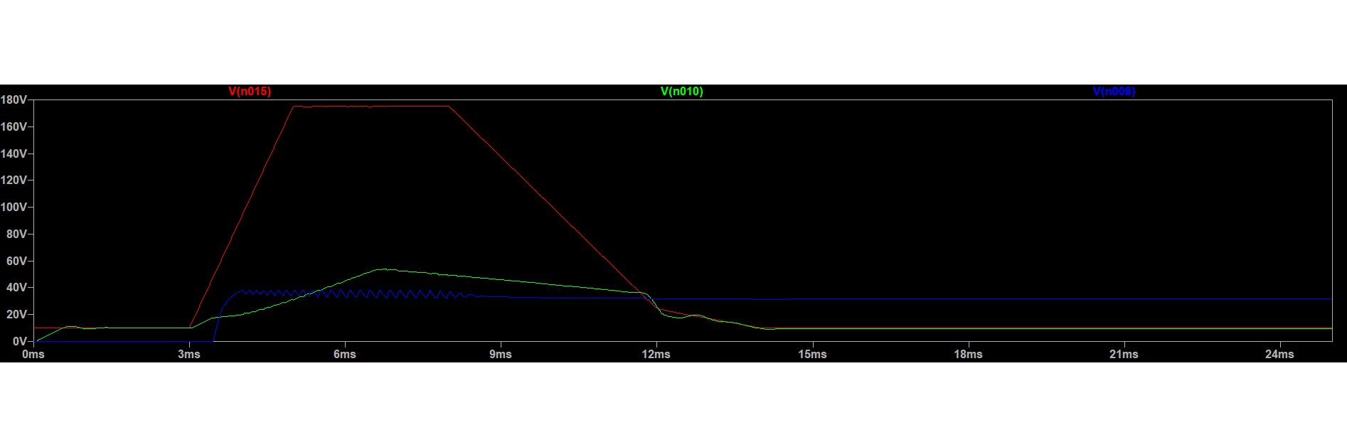

LTspice and jpeg as attached. Also, a waveform plot of Vin, Vin at FullBridge input, and Vout during the surge, when on full load.
I think four pllel flybacks, with FETs capable of handling 350V, would be a better way?
Would you agree? (ie, instead of three surge bucks and one Full Bridge)

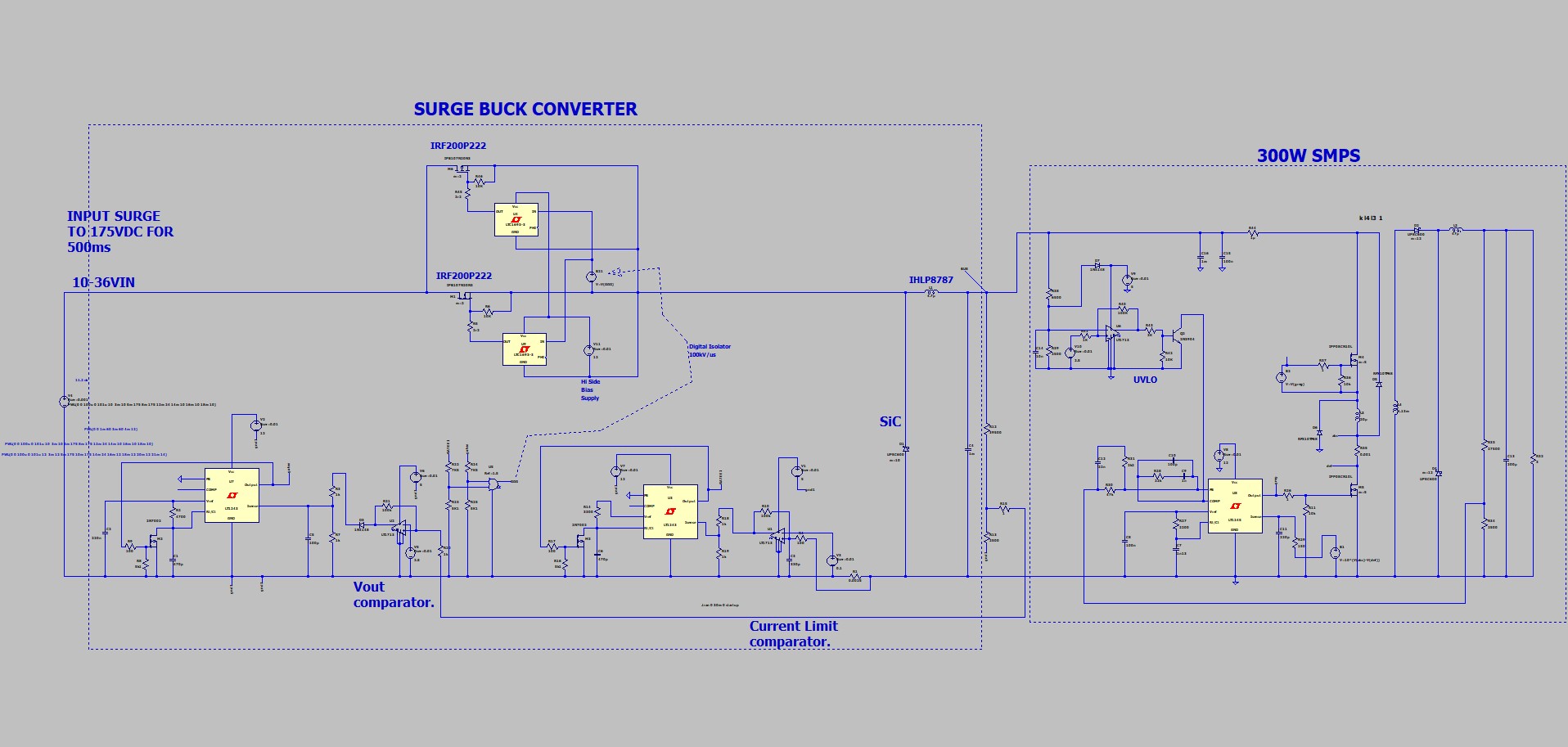

The attached appears to be THE way to implement this ugliest of all converters...the Surge Buck Converter.
Needs the hi side supply to be added for the gate drives.
The delay time on the high current sensing comparator is the key to the whole thing.....making it about 150ns in delay time sounds about right.
Would you agree?
