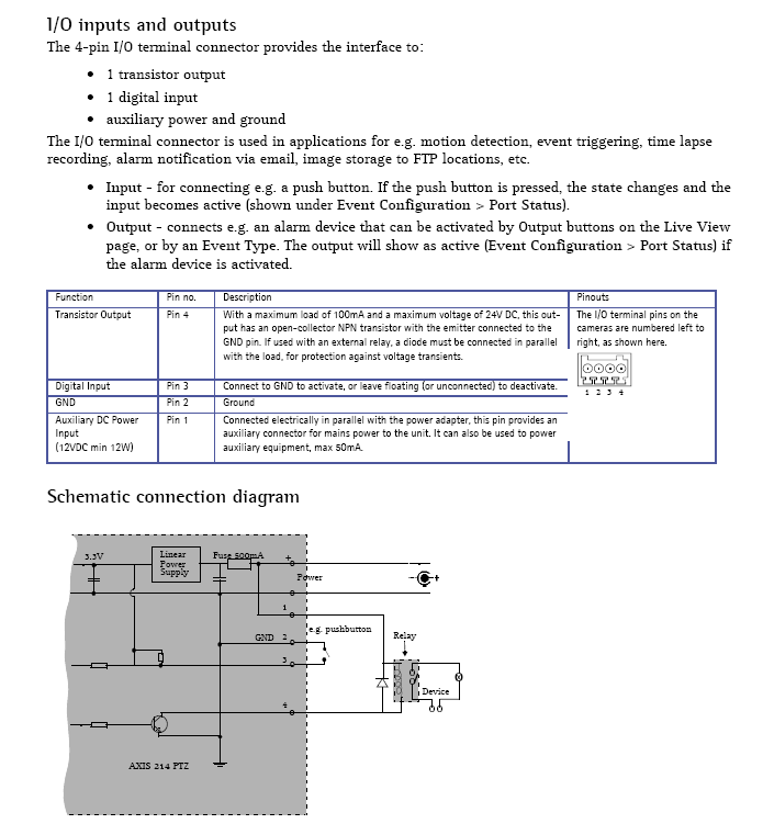

I have a device (a camera, but that's not important) with an integrated I/O port, which is similar to a contact closure. Actually, it may be exactly like a contact closure, but I'm not sure, since I'm not familiar with such equipment.
Anyway, I'm able to close the output circuit remotely (via software). What I want to do is use this I/O port to turn on a standard electrical device (think of the standard device as a light bulb). The device runs on standard 120V AC.
Please see the attached diagram for information on the I/O port.
My question is: how would I wire up the light bulb to turn on when the I/O circuit is closed? What parts (available from Radio Shack or such) would I need to buy, and how would I connect it all?

In your datasheet there is just what you want:
Put a relay with its coil between pins 4 (transistor output) and 1 (power).
Don't forget the diode (anode to pin 4, cathode to pin 1). It's there to protect the transistor aganst the relay's voltage spikes.
Select a relay with a coil's voltage that matches your power supply (may be 12 V, but check your power supply), and with contacts rated for at least your load's voltage (120 V AC) and current.
The diode may be almost any type, like 1N4002 or 1N4148.

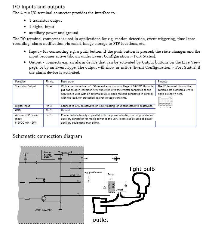

So - just to be clear, I would then wire in the light bulb like in the attached image?

Thans mvs sarma, but none of those terms mean anything to me. I truly don't know anything about electronics.
Is my basic wiring diagram for the light bulb correct?

Almost OK :D
In the original image there is a "second DC power jack" (at the right of the relay). You should not use it, the "120 V" side of your circuit is:
Outlet (hot side) --- Relay contacts --- light bulb ---- Outlet (neutral)
Be shure to use normal line voltage wiring and safety practices - isolate (or enclose) all exposed connections.
