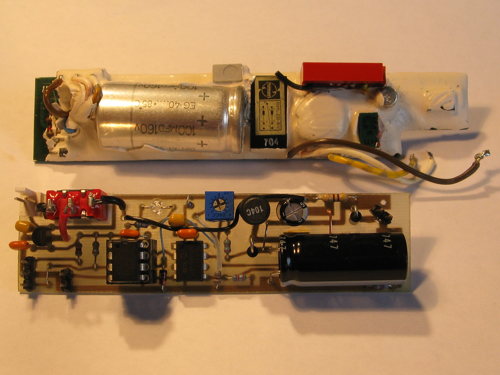

No, its not a taser. It fires a solenoid. The application is for a replacement board for a Walther Model FP Olympic free pistol. This is a single shot .22 pistol that shoots at a target 50 meters away; the bulleye is 50mm. It is considered the most challenging of the Olympic pistol events.
Walther sold this unique design in the late 1980's. The trigger is fully electronic. An opto- interruptor trigger uses an LED and phototransistor. The firing pin is a solenoid. There are no mechanical action parts like those found in other guns.
The board used logic and analog chips of the vintage. Walther farmed out the boards and couldn't resolve ongoing electronic issues. Eventually, all support stopped and users were left with expensive door stops. Today, a similar, mechanical paper punch costs about $2200.
My intent is to develop a replacement board. I've been successful in developing a design that works and fits within the confined space. My design uses through hole components so it can be constructed by non-electronic builders. I've been working on the design for a number of months through five different boards. My intent is to make the design freely available. I have no desire to market a product because of liability issues
About 2200 of these were built. Many of them are in Europe.

I've loaded a picture of my new, fifth board, and the early Walther board. Note the relay! The schematic I posted earlier was a later SMT Walther board. Multiple factory board designs has complicated my task.
I'm math savvy so I've used several calculation worksheets in this design.
I originally used a 14 pin PIC and varied the period and duty based on battery voltage. This went out the window because it was too complex. My third board used SMT components. Then I realized that design would limit my "market" so I reduced the pin count and went to simpler construction. My current board is even single sided with a few jumpers.

If you use an 0.1 uF capacitor, that will basically provide enough charge for the ADC. The resistance of the potential divider then only needs to be low enough that the voltage on the 0.1 uF capacitor doesn't lag the storage capacitor too much. You could certainly have 1 Mohm resistors. In fact leakage could become a problem. The time constant will be less than 0.1 s which is pretty quick compared to the charging.
The circuit that has a 47 kohm in the divider will have a time constant of 5 second for discharging the 100 uF capacitor. That means that it will loose as much charge in 5 seconds as is in the capacitor. If you go to a 1 Mohm resistor, the time constant is 100 seconds.
