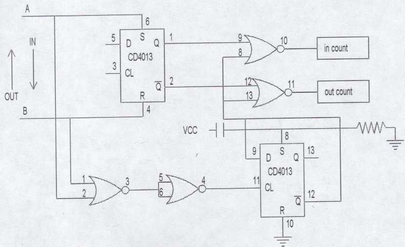

This is how I would do it. If you have dificulty following it, post back.

tried out a lot analysing the circuit but not getting the exact functioning...can you help with the operation...please!

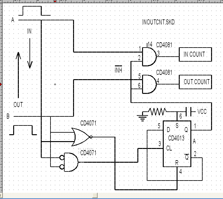

The circuit had problems, so I changed it to this: The sensors have to be close enough together that a person can't get between them. When an in or out count is made, the flip-flop is reset which inhibits further counting. When the person has cleared both sensors, the signal goes low which clocks the flip-flop putting it in the count enable mode. The R-C is to set the flip-flop at power on to enable counting.

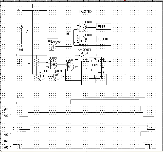

I keep finding logical errors in the circuit, so this time I drew the waveforms to verify that it works. The two sensor beams have to be close enuf together that both are blocked for a short time when a person passes thru.
