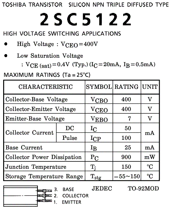

Need Equivalent for 2SC5122
Maybe this datasheet help for searching. 5122 manufactured only Toshiba.
