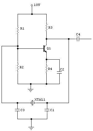

Need Explanation "Crystal Oscillator"
Ayne
Below is a circuit,
I need explanation that how it start to oscillate.
Plz tell me step by step procedure.
A small amount of noise from the transistor or resistors or just the "click" from power being applied gets amplified by the transistor and is phase-shifted 180 degrees by the crystal and its two capacitors, causing the feedback to be positive. The positive feedack is at the frequency passed by the crystal and keeps the oscillation going.

I forgot to say that the transistor is an inverting amplifier that provides the other 180 degrees phase-shift. So the total amount of phase-shift is 360 degrees.
