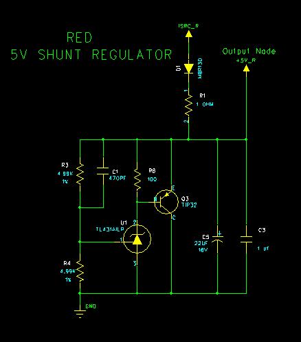

Hi All!,
I'm trying to figure out how this 5V shunt regulator works and am just confusing myself. I attached a schematic to avoid confusion.
I see that R4 and U1 are where the engergy is shunted to but as for how the PNP dumps this energy there to be dissipated is confusing. Does anyone have a simple explanation at to what's going on here? I know it's not too complicated....

Pin 1 senses the overvoltage via R4 and "fires" U1. The current flowing through U1 also flows thru R6, and the resulting voltage at the connection of R6 and the transistor biases ON the transistor. Now, current is "shunted" thru the transistor, instead of towards the output.
At least that's how I think it works.

This circuit is being used to regulate a +5V keyboard. It is from an older design and I wanted to get an understanding on it since I didn't do the design and will probably need to de-bug at some point.
I understand now that the excess voltage turns on the BJT which is where the current is "shunted" away from the output.
If you were to regulate this circuit to have +5V at the output node at all times how would you pick your reference voltage at U1 pin 1. I know it's only a voltage divider...but I guess what I'm really asking is how do I pick a the correct reference voltage so the zener turns on when the output goes above +5V. I've looked over its datasheet and don't get a clear answer.

I think the way it works is as a zener reference regulator. The zener gives a fixed voltage to the base. The emitter voltage adjusts to 5 V to make the emitter-base voltage constant. The datasheet for tip32 says the VBE is 1.8 V, so I'd assume since it's a PNP, then the zener would be set at 3.2 V. The reference voltage across the zener is adjustable by changing the values of R3 and R4. Anybody correct me if I'm wrong. I'd assume c5 is acting as a filter to keep the voltage at the emitter more stable. This is all assuming that the voltage coming across D1 is pulsing DC.

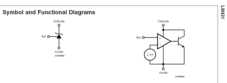

Look at the attached simplified equivalent circuit taken from the LM431 data sheet. Note that if Ref (+ input of the opamp) is a mV or so HIGHER than the 2.5V reference, the gain of the opamp drives the built-in NPN into conduction, pulling the Cathode voltage down toward the Anode.
If Ref is a mV or so LOWER than 2.5V, then the NPN is off, meaning that the external circuit can pull the Cathode up as high as it can (no current flows through the collector of the NPN).
Note that in your circuit, the Ref input is driven by a voltage divider consisting of two equal value resistors (1% no less), so that sets the regulation voltage at twice the internal 2.5V reference, i. e. 5V.
Also notice that if the output of the regulator is slightly higher than 5V, that makes the Ref input slightly more than 2.5V, which causes the LM431 to sink current out of the base of the power PNP TIP34 transistor, which gets amplified by the β of the transistor, which causes a much larger current to flow from the output node to ground via the collector of the transistor.
The transistor current adds to the current flowing in R1 (1Ω resistor), which increases the drop across R1 in an amount such that the voltage at the output stays at 5V.
Another way to think of this is to suppose that the external load on the power supply was suddenly cut in half. The reduction in current would naturally cause the output voltage to rise. However, the TL/LM431 sees the increase in output voltage and reacts by turning on the TIP34 harder. This "shunts" current to ground exactly offsetting the reduction in load current keeping the drop across R1 (and the output voltage) constant.

I meant the data sheet for U1, sorry. It's OK though, I looked it up. Like you, I first thought it was a triac, but it's really a programmable voltage reference that "turns on" according to the equation:
Vo = (1 + R1/R2) Vref. - Where R1 and R2 are R3 and R4 in your schematic, respectively.
From the data sheet, Vref is near 2.5V. Using the approximation, we can calulate R1/R2
R1/R2 = Vo/Vref - 1. Since Vo/Vref =2, R1/R2 = 2-1 = 1. Thus, R1 and R2 are equal value.

1. How did they pick this transistor. I know that it's in the datasheet as an example application so I would know to use a PNP but what about predicting the base current so that the transistor is 100% on when U1 conducts. I guess what I"m asking is the transistor is normally cutoff.(no regulation is happening) Then when the supply voltage goes above 5V the transistor is saturated letting current run through it. Do I just assume that no matter what U1 will hold Q3's base at 2.5V which will definitly make the 1.8V difference b/t the base and emitter?
2. What is the significance of R1 and D1?

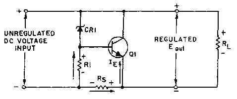

from
SERIES REGULATOR
"SHUNT REGULATORS use a variable resistance placed in parallel with the load. Regulation is achieved by keeping the resistance of the load constant. Characteristically the resistance of the shunt moves in the opposite direction of the resistance of the load."
For PNP just flip it so the PNP emitter is in the place of the NPN collector, and the - is the same as your ground.
Q3 never saturates. As the voltage at it's emitter ( the one with the arrow ) attempts to rise higher, it will conduct harder and harder to maintain a constant voltage. The increase in conduction of Q3 is driven by U1, according to the schematic of U1 that MIKEMI provided. The purpose of R1 is to provide a voltage drop from the unregulated portion of the power supply to achieve 5V at the output. Without the resistor, there would be no control of the voltage, no matter how hard Q3 was driven.
As for D1, I'm not sure. It's existance is dependent on the type of power input. All I can say is that it prevents current from flowing up, away from the rest of the circuit.
