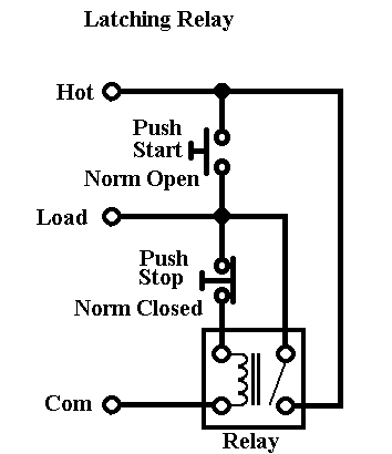

you can get latching relays. I haven't looked into them much but i imagine it would be very simple to have one button to trip the relay(alert), and one button to shut it off. (cancel)

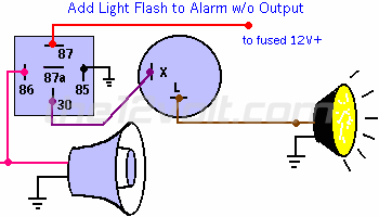

Here are some circuits you can combine.

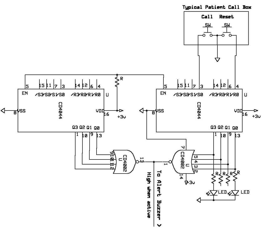

Here is a quick shot using IC's. I did not verify all, but should work.
Possibly someone else can contribute a 555 driver oscillator for the piezo
buzzer portion. You would get better range on the room signal leads if
you upped the supply voltage to 9VDC.
Edit..I think I may have the alert signal state wrong in the schematic.
You'll need pullup's for those switches and driving led's directly from a 40-series might not work ( depends if the chip is in the mood or not :lol: )

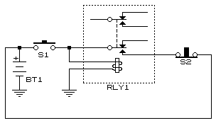

Here's a latching relay circuit like the one Hotwaterwizard described.
You can use any DPDT relay for this, as long as your battery (BT1) can provide enough current to actuate the relay. Press switch S1 to activate the relay, press S2 to de-activate it. Use the second set of contacts in the relay to operate your lights, buzzer, etc. You could probably build a circuit like this and put it in an enclosure for $10-15 US each.
I'd probably use a 9v battery (maybe even a 9v lithium) instead of the rechargeables, they would probably turn out to be a maintenance headache. 9v lithiums are about $10 US each though.

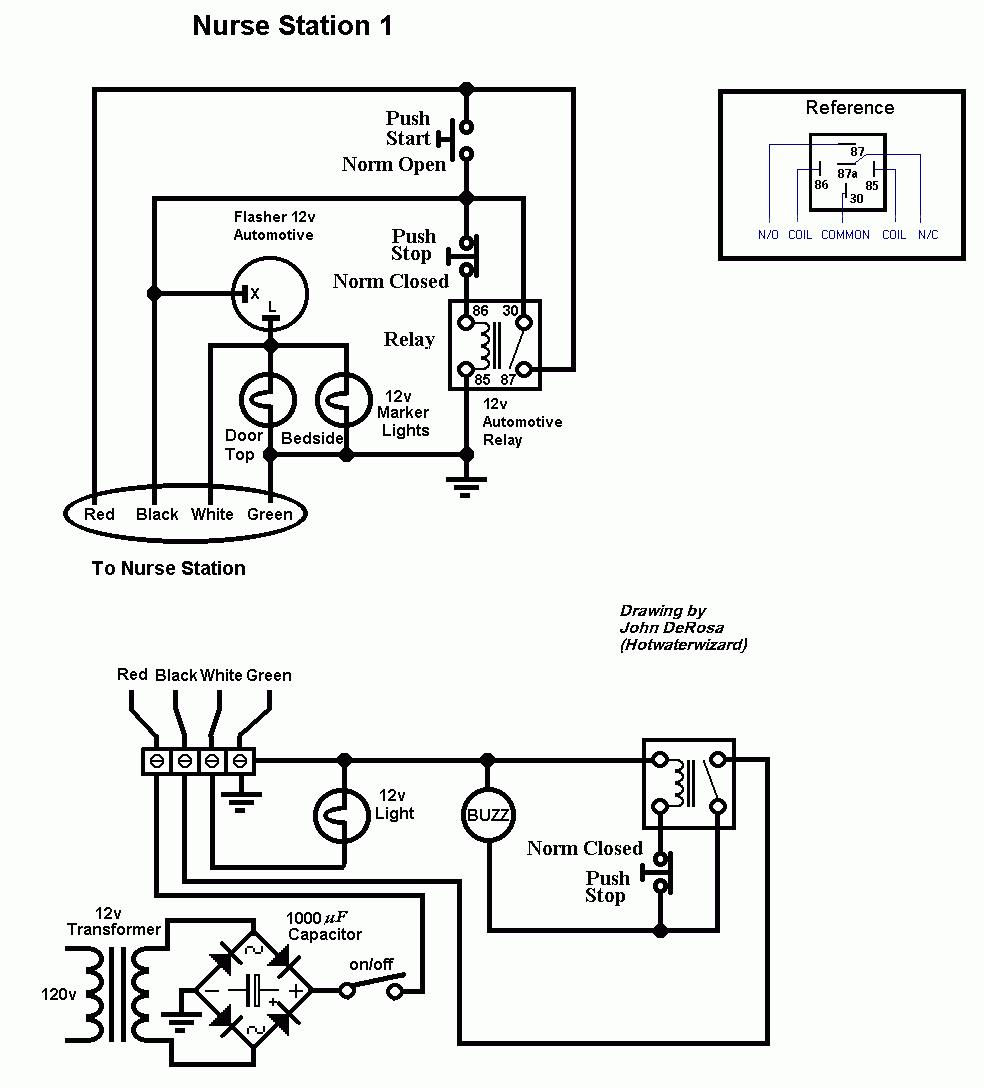

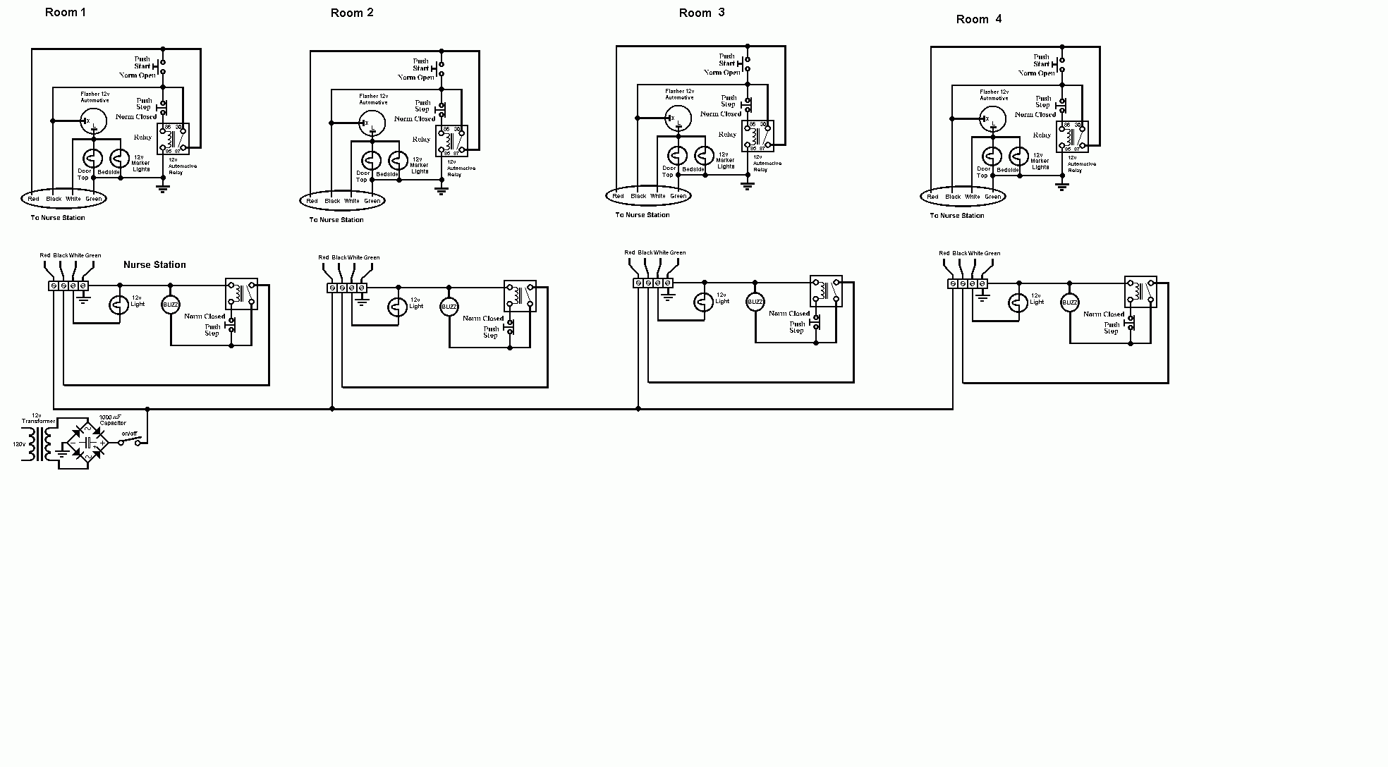

Here is what I came up with. You will Reuse the Power supply and repeat the rest as needed.
I expanded it to 4 rooms.

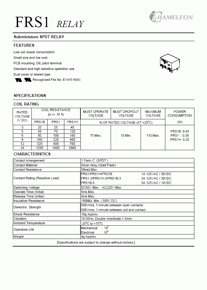

using an FRS1 Dc 6V 1A/125VAC -
John DeRosa (Hotwaterwizard)

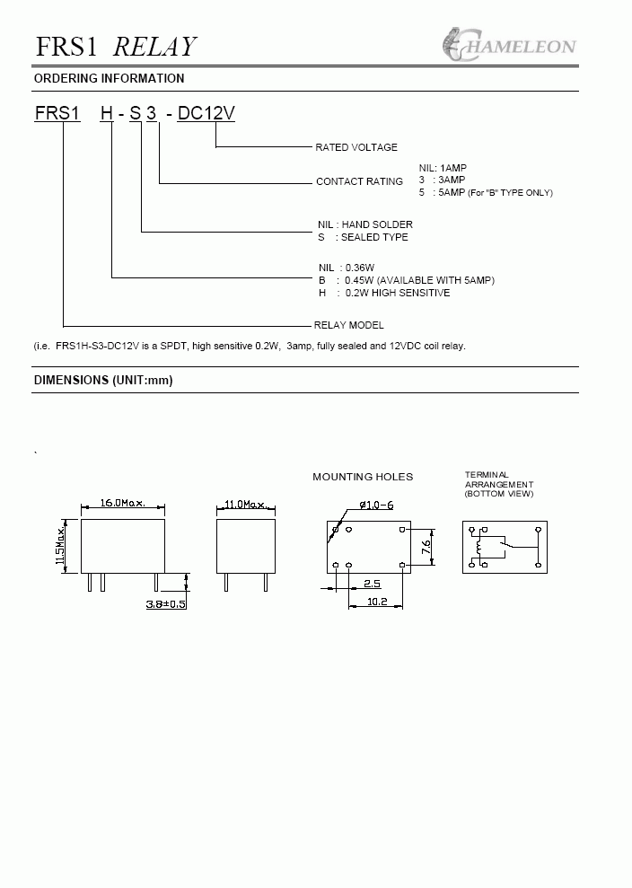

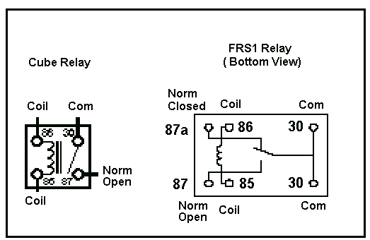

I am using the latching relay circuit you suggested and to shrink the application down in size and power requirments I have substituted the 12V auto cube relay for a n FRS1 but I cannot find for the life of me what the equivilent pins are on the FRS1 to the 12v cube relay.
| o o o|
| o o o|
If anyone can point me in the right direction I would ver much appreciate it..
Just incase you can't open the Datasheet Here is a copy in a different format.
I cant thank you enough
Hopefuly after some time I can give to others as you have for me here.
Thanks again, this forum's a great place to learn about electronics and the help from users is 2nd to none.
