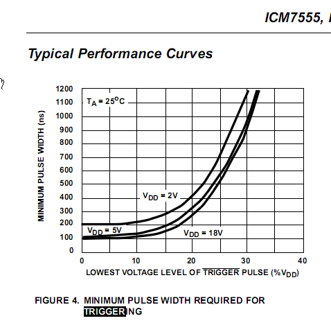

basically what i wanna do is to generate an output that is suitable for the parallel port lets say for about 1 sec so that my software will be able to detect the generated signal from the coin mech
i have an idea but i don't know if it's possible so i'll just ask for your ideas
1)directly send the negative going output pulse to LM555 (configured as a monostable) trigger and then feed the output of the monostable to the parallel port

I did suggest a HEF4528 dual monostable in a previous post.:)
Im not sure if a 555 is fast enough to respond to 20nSec trigger pulses.???
I'm not even sure the cable is fast enough to respond to a 20nS signal.
I've also never heard of "SR" as a coin mech manufacturer, and I notice you didn't post a model number or anything.
