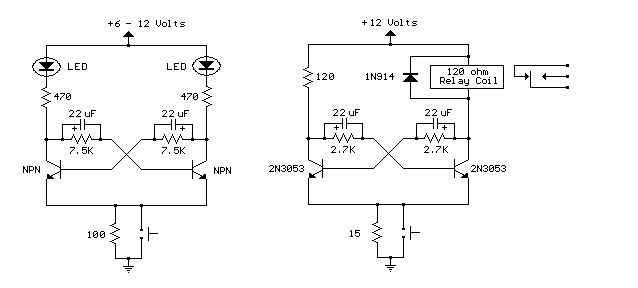

What is the common and easy to do application of bistable multivibrator? I really need suggestions of the simple application.
you want to make a flip flop?
no sir, what I'm up to is the application of the transistor bistable multivibrator, for example is the flashing led using transistor bistable multivibrator, something like that, I really need ideas here.
uhm, is that a astable circuit? That's just my guess, I ddn't know that it's a astable circuit, that's why I'm asking suggestions for the bistable.
A bistable circuit has two stable states. An astable (multivibrator) circuit oscillates between two states. The term bistable multivibrator is a contradiction in terms.

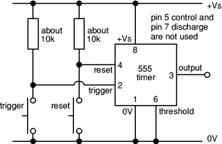

uhm, there is this 555 ic timer as bistable, i already know the circuit, but can I convert it to a transistor bistable? If so, please tell me how.
Circuit
Is this what you are looking for? Compare to the 555.
